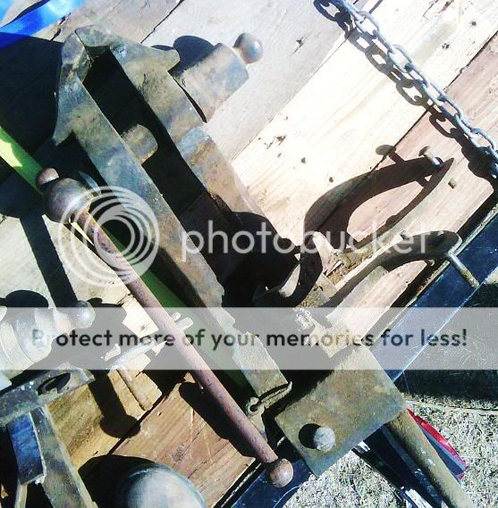

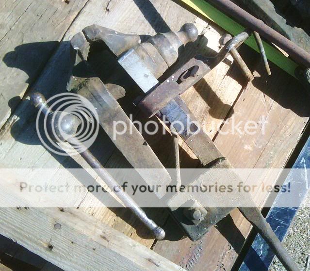

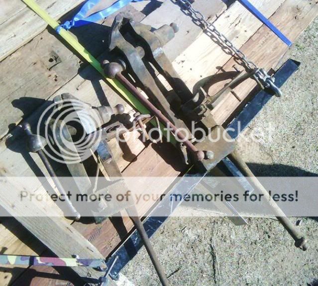

I got these from the two farms where I grew up. The big one will need some work on the mount. It needs a spring and some wedges. The smaller one is in good shape and should be ready to use once mounted.
Tips on mounting them?
