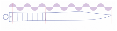

This is the blade style you are going for? (Not my pic)
I want to play,
On a broken back seax like this one I put the point just about inline with the bottom of the narrowest part of the handle. Then give it a little belly from the handle to the point. At the widest part of the belly is where I put the broken back and it's the same height offthe center line as the belly. The entire blades is one long flat grind from tip to butt. This causes the apex of the broken back to be wider. This one was around 1/4" at the handle and if I remember correctly close to 3/8" at the apex. It really puts some weight in the sweet spot.

Ok so almost no belly, but a little bit of curve extending wider then the hilt into the tip that is dropped definitely below Center.
