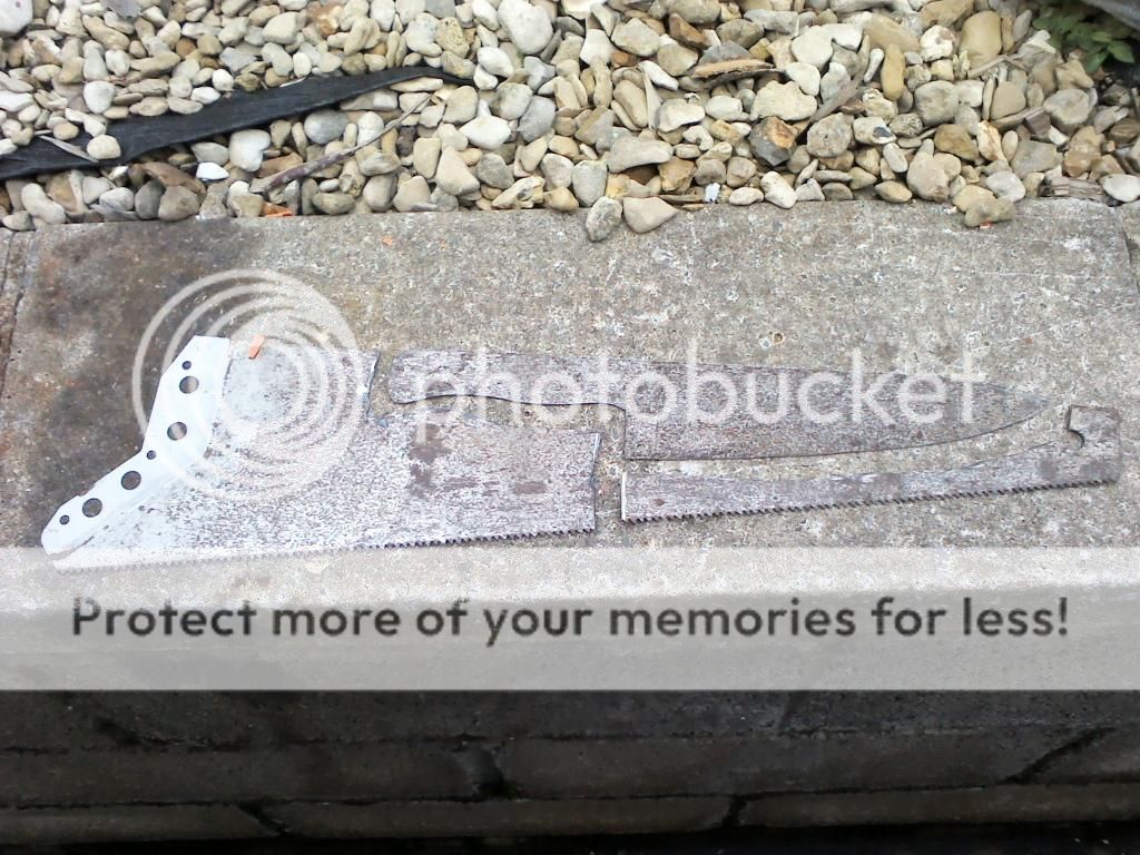

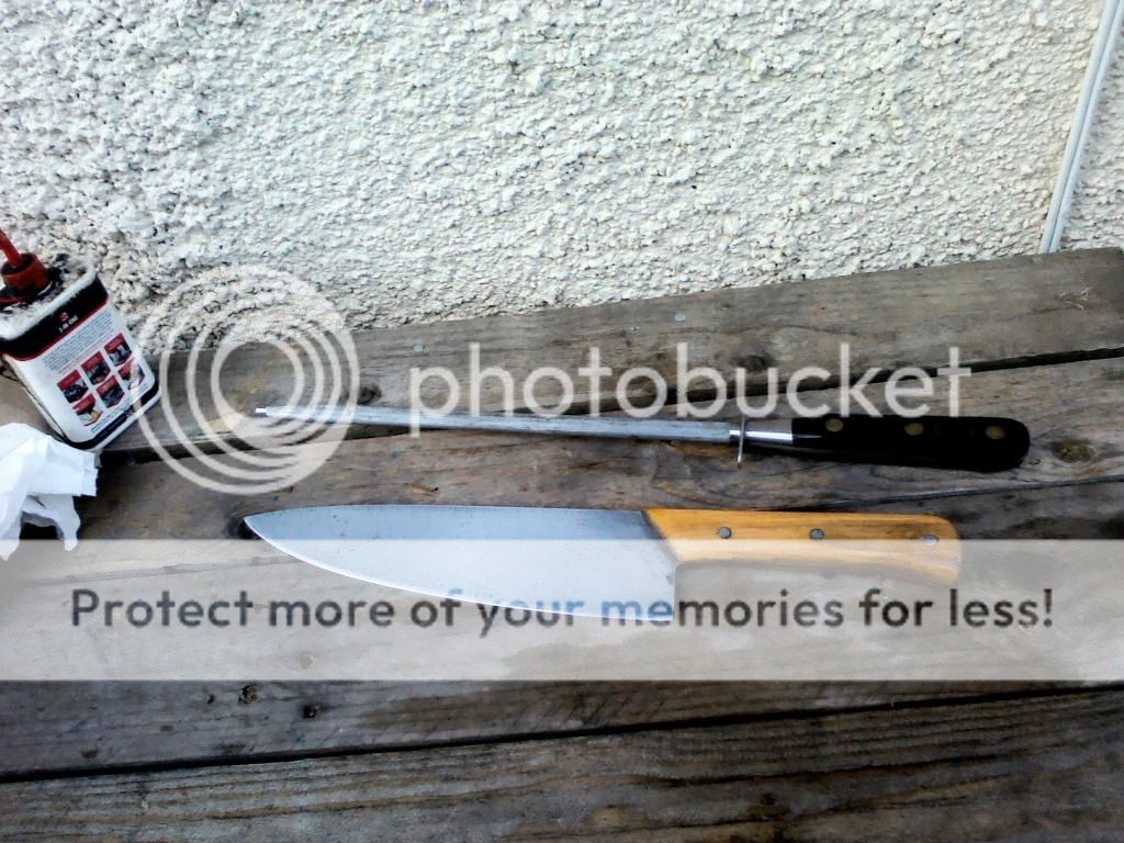

I'll be making my own from old Disston wood saw blades. I made a nice kitchen knife a while back from a similar saw and it turned out well, the steel is good enough to get and stay sharp to use around the kitchen. Obviously the better saw I use for steel will be made of better stuff. And I know a place full of rusted and abused old saws that I can harvest. The fact the blades are very thin makes them the most devilish slicers I've ever used! lol
I think I will use epoxy though, as I want them to be as safe to use as modern tools. I'm more so going for the look of the traditional ones, rather than the true technique. But I will peen the brass pins, giving the look, with the glue sealing the handle from blood and gunk etc.

That looks really nice. And it is as good a blade as most could get in the 19th century. Are you cold working the blade through the finish or heat treating before finishing?
Also, let us see the designs you come up with. Your saw still has a couple of paring knives in it and maybe a small fillet knife. :)
I carefully cut and shaped thsteel, leaving it's original springy temper as it is. Through constant use of the one I made, ive realised if I had the stock, i d go for slightly thicker steel. But its a demon on the black and cuts very well. I still have the left over blade so dont worry about me wasting it! :D
Also, this is a pattern for a fillet knife I drew up for a different saw blade, im pretty sure its a disston, and too mucky to salvage as a saw.
