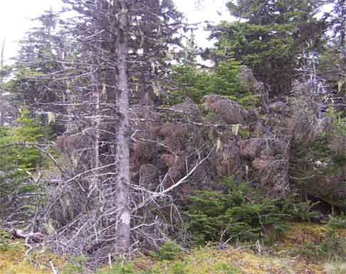

On softer woods the knife will go ahead even faster, and if you look at things like limbing it is literally comparing seconds to minutes. A seven ich blade can sweep the brush from around a tree, clear off the limbs to height, fell the stick, and clear off the rest of the tree, all while the saw is still trimming the brush. For example :
The dead stick in the foreground has lots of dry wood in the limbs for burning and the trunk is suitable as well. The stick cracked off in the background has a massive amount of limbs for shelter, or bedding or burning and is fairly readily itself used as a base for a debris shelter. Doing this chopping work is a very long time with a SAK saw, very fast with a Ratweiler.

The branches on the above tree in the picture are not even large ones and it takes a massive club to crack them off and you are not doing it by hand, well most people could not anyway. Cracking them off with a stick also leaves very sharp stubs on the tree which makes it much more difficult to handle, plus it scatters the limbs all over the place sending them flying which has obvious drawbacks. Now if the tree has core rot you can usually break them off, but there are many trees for which the branches will be very hard and still very springy and you are not cracking them off at all. You can club on the limbs of black spruce all you want and it doesn't take much of a limb diameter wise to support the weight of a man, so ripping them off is difficult.
