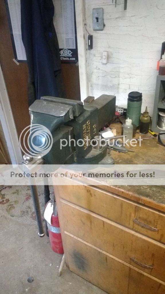

And one bit of housekeeping, vises are not anvils. Unless your vise looks like this (my 7.5" Peter Wright, but applies to any post or blacksmith vise) it really shouldn't see hammering beyond driving out a stuck handle pin, or center punching holes. This is the result of excessive hammering
that is a beautiful old 3" American scale (Kansas city MO) that had the jaw support busted off. I've built it up with braze, and am ready to machine it. It can be repaired but unless it's a reasonably valuable vise such as this, it's usually not worth doing.

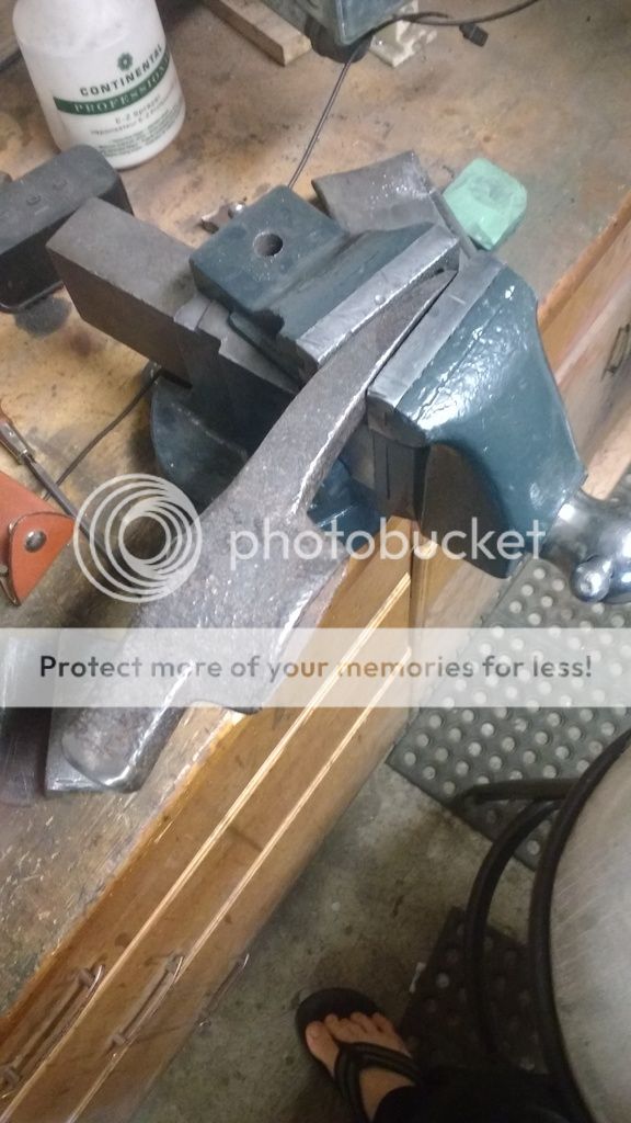

Now for the most useful vise (in my opinion) in a knife shop, the swivel jaw machinist vise. This one is a rock island, and happens to be a dual swivel (swivel jaw and base). These are mostly antiques, and I don't believe anyone is still Making them, with the possible exception of Morgan. However used ones are out there, and I've found two for my shop. They are easy to identify by the pin sticking up from the back jaw. Be sure to look carefully around the jaw for cracks or welds. Some of these are broken, and some were welded solid by someone who didn't like the feature. I didn't have a tapered tang without a handle already on it, but imagine this broken pickaxe is a knife. I'm sure you can see why these are so useful.
This vise has 3.5" jaws, and I use it for 99% of my work, dozens of times a day.

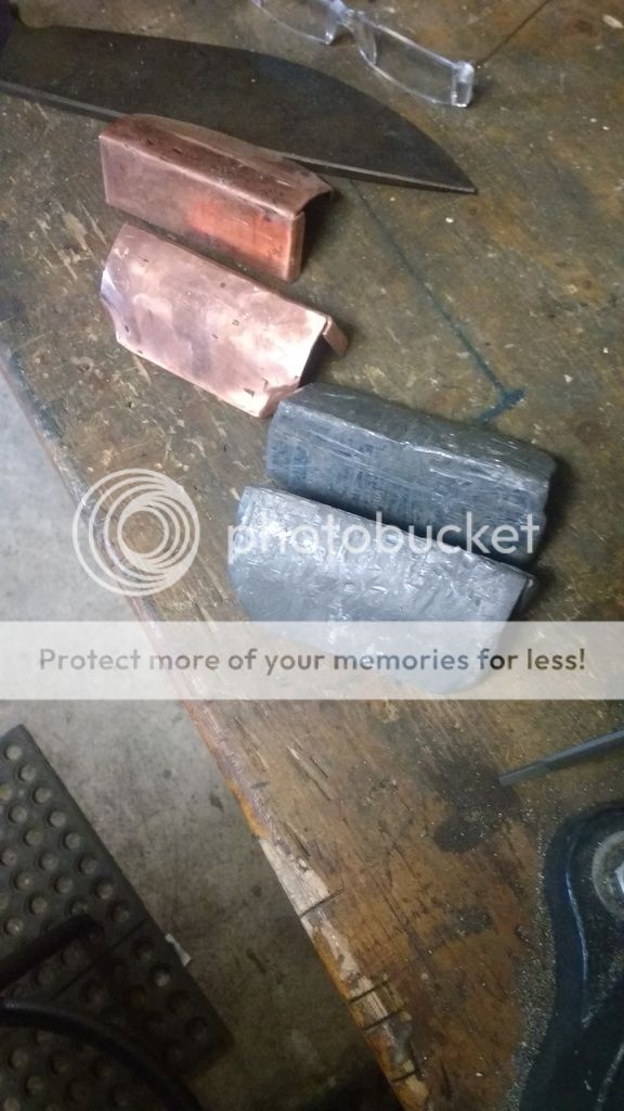

A few other things worth looking at are accessories to go with your vise. The first is soft jaws. You can either make solid aluminum, brass, copper, or micarta jaws, or make covers for them. I personally like solid copper jaws, but haven't had a chance to make them yet. For jaw covers I like having two sets around for each vise. One of copper, and one of 1/8" sheet lead. The lead jaws are especially nice for finished parts, as they will not mark anything.

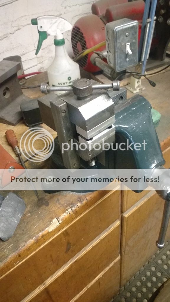

Another thing that can be useful to have is a small toolmakers vise. These can be purchased from a machine shop supplier, or online. This one is actually a first year apprentice project from the local navy dockyard. It's not pretty but it works well. I use it for holding pieces 90 degrees to what the vise normally will.
A kmifemakers vise would fill this last role as well, and is probably a better option. I've just never taken the time to actually build one.

I use leather inserts to protect my work from the jaws. They are three thin layers with magnets between them to vate them stay put
Leather is another great option. I've go a set of plywood jaws with leather cemented on them for working in my guns. No chance of scratching the finish. I've personally found it worth having different jaws for different applications. Saves tearing up the really soft ones for things that don't require it

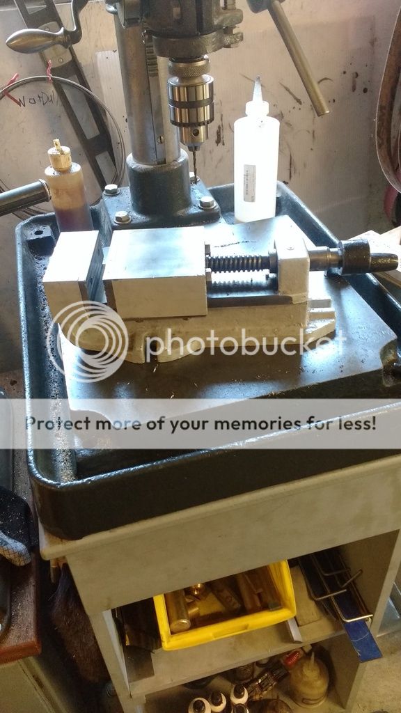

I keep a different vise on each of my drill presses for different applications. The first one is a 4" milling machine vise. I like that they have a lot more mass than a standard drill press vise, so you can use them free floating instead of having to clamp it down for every hole.

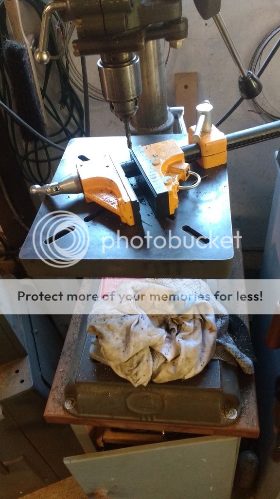

I keep a floatlock vise on my other drill press. These have a few useful timesaving features including rapid adjustments between clamping sizes, the ability to quickly position and lock the vise anywhere on the table with a turn of one handle, and the built in parallels and V blocks in the jaws.
These are not the easiest to find, but I'd highly recommend it if you ever come across one. I'd estimate it's reduced the time spent setting up and drilling by close to half.
Ah.. The Floatlock Vise. I forgot I have one of those. Its missing its tableclamp. Maybe thats the reason I set it aside for so many years.
btw use the flesh side of leather on your work, the smooth side can scratch brass etc
I've actually found the opposite of that to be true? I find the flesh side to collect dust and grit a lot easier than the hair side.
I still think lead jaws are impossible to beat... It's just a matter of finding heavy sheet lead
I find that surprising, I've never actually ran into that.
Usually if something is at its final polish I'll wrap a rag around it too, just to be on safe side.
