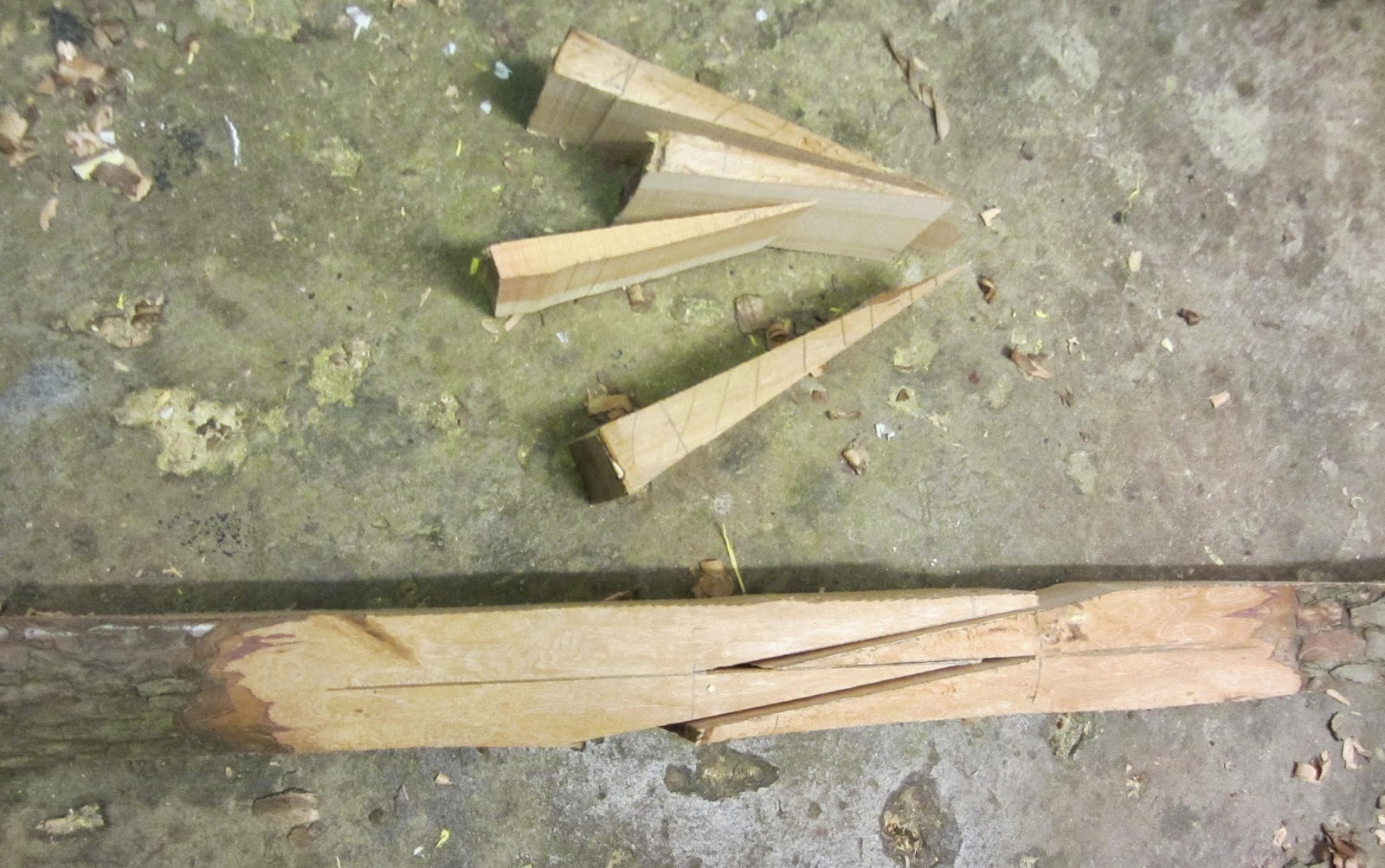

I noticed after 15 or 20 swings that chopping with one bit it had a greater tendency to bounce out. Upon closer inspection when i stressed the joint i found this...
If i hadn't noticed I would've split this haft all the way up! To fix it I'll have to devise a rivet about an inch above the joint. I was hoping this might be a feasible way to shorten a 36" haft but it turns out not to be in practice. There's a whole lot more stress throughout the whole length of the haft than I had thought. Anyhow I've got some other glued joints that I'm trying out. I'll post an update on those when I use them some more. It's fun trying unorthodox things as long as it's not unsafe.

What you need to do is avoid sharp edges. In this case its where the 2 lines meet. There will be surface tension there, which will always take the path of least resistance. In this case you can see that the crack started because you sawed the length a bit further then you had to, and didn't round of the edges. Thats what started it all. I have seen this a million times in Motorsports, where parts just sheared of and accidents happened. The reason always being: not enough attention to detail in the prepping stage.
Yeah this was uncharted territory for me and I was kind of winging it. First time trying it so I really didn't have a clear plan. Just an idea. While you are correct, my jointery was pretty bad, I'm confident that done the same way again perfectly it would still split up the haft like that. It needs a rivet, or something like that, above the half lap. Next time I'll capture the top in a 22.5° angle and fashion a rivet. I may even disassemble this one and add both. I'm pretty sure if I tried using a 1/2" stick for a handle it would probably break then too. After all that's about all that's left in that half lap.

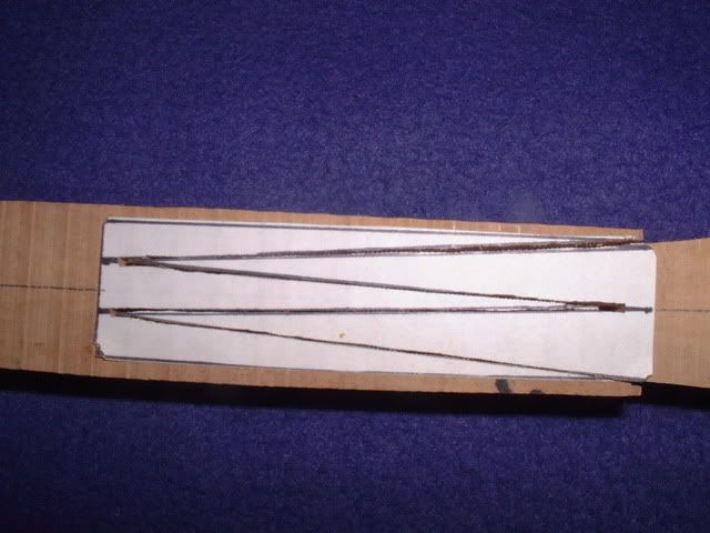

Josh,i'm not sure how you'd fix this joint now,but for future reference maybe this will help.
This failure was inevitable,it is caused by the "hard spot",a stress-concentrating point(that inside 90 deg. corner).
Wooden members can't join like that,not for continuity of longitudinal loading.
There's a number of scarfs that avoid that,simplest i can think of is a swallow-tail.That is pretty much a simple V,and i'd point the tip Away from the axe-head).
Number of other configurations exist.The idea is to not have a joint line that is perpendicular to axis of stress,but as slanted as possible.
Also i'm not sure what you used for glue.Resorcinol of some type would be ok(like powder form Weldwood),i'd also experiment with polyurethane ones,they're "gap-filling" type glues vs the former,as well as more elastic.
These are all just loose suggestions,i'm sure you'll find a way to resolve it all.
Best of luck,great job on them handles.
