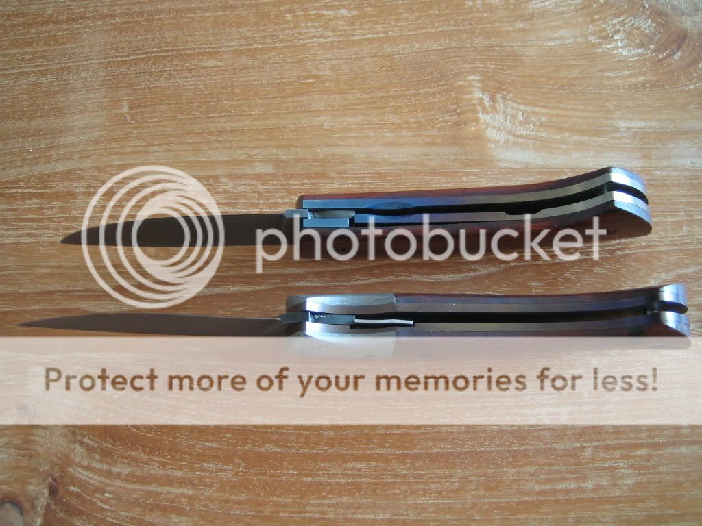

Well first let me point out they are quite similar.
As one can tell from the pic. (Frame on top Liner lock on bottom)
They both follow the same concept. I would think that Frame locks are a bit stronger since they utilize more metal and thus more force from frame. That however is my opinion not fact. I am sure depending on material and build they can be interchangeable.
You could argue that the top one is also a linerlock because the lockbar is covered by a scale, which really imparts no benefits that a traditional framelock imparts. Framelocks let you squeeze the lock bar when you grip it. With a scale covering the lockbar, you cannot do this.
Something you might notice is lots of custom knives using frame lock then a production version using a liner lock. That is because less material tends to keep prices down. Also as far as I know there is a fine line separating the two. Some company's may try to say a thicker liner lock is a frame lock and in part they may be correct though I don't have a hard definition for you.
I would also call that top one a liner lock nate, with a liner as thick as a framelock! But since it is covered with a scale it would be considered a linerlock, and nothing wrong with that. I have more linerlocks than any other locking system, and have had no trouble with them. As tsujigiri said "Either one works really well if done right, though". And that is what it all boils down too.
Thank you for the comparison. I was thinking more along the lines of a Strider or Hinderer where the handle is the actual lock.
