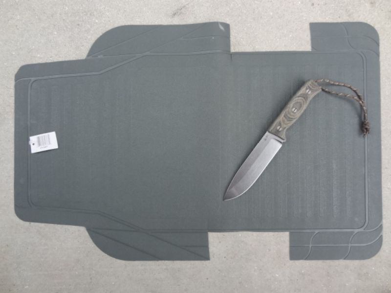

I saw a guy that made rubber ones from the trimmable edges of a car floormat. I will look and see if I can find the thread
Adding liners made a world of difference on my GSO 6 and GSO 10. The matts came from Pep Boys for about six bucks each. They have black, tan and grey.
I went with grey on the GSO 6 and black on the GSO 10.

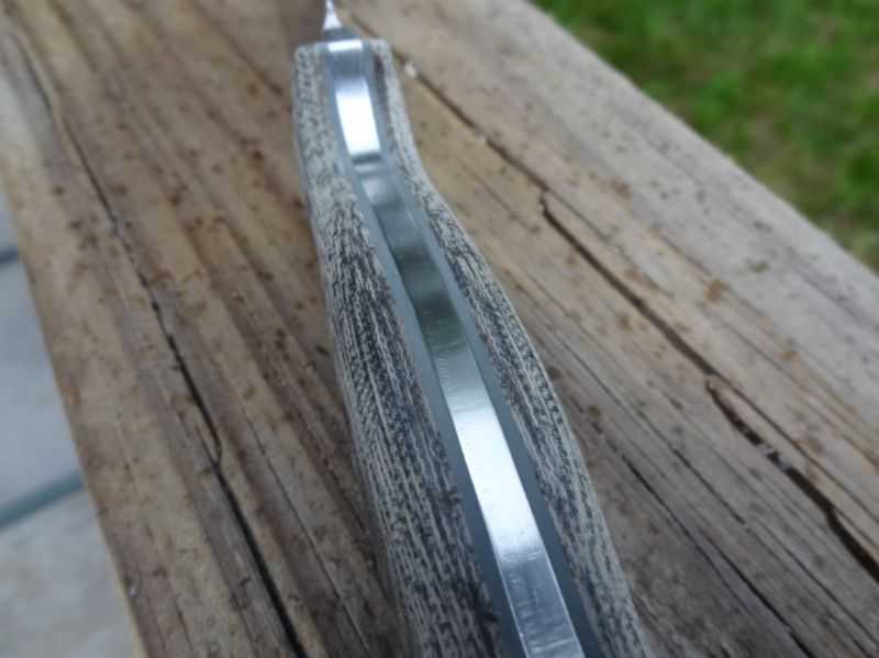

GSO 10 with black liners:

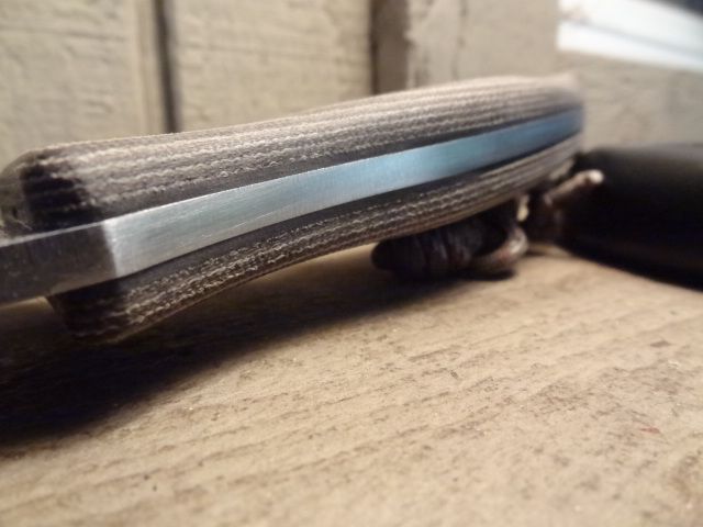

I finally got around to adding liners to my GSO-10, took me a while because I couldn't find those trimmable car mats close by and low enough cost, ended up tracing/cutting liners from an old wheelbarrow inner tube. What a difference!!! I'll post pictures either this evening or tomorrow when i have a chance to take some photographs.
By the way, the tricky part was remolding the sheath-mouth to provide proper retention on the thicker handle - you have to heat it up to loosen, then repress tight but with a spacer around the blade and a flare at the lip so the knife still goes in easy. Thanks to FTR-14c for the inspiration!
Here are mine, again used tire inner-tube liners, they aren't as clean as FTR-14c's work (should have used an exacto-knife to cut them out), but they do make a world of difference in how the handle fits your hand:
I'm glad you took the plunge and went for it. The sheath adjustment is a small price to pay for what you get back in comfort.
Good thinking on using a tire tube. Almost anything will work. A guy on the Becker forum used a bit of rubber shower liner on one of his knives.
It is amazing that such a small amount of space can completely change the feel of a handle in a positive way.
