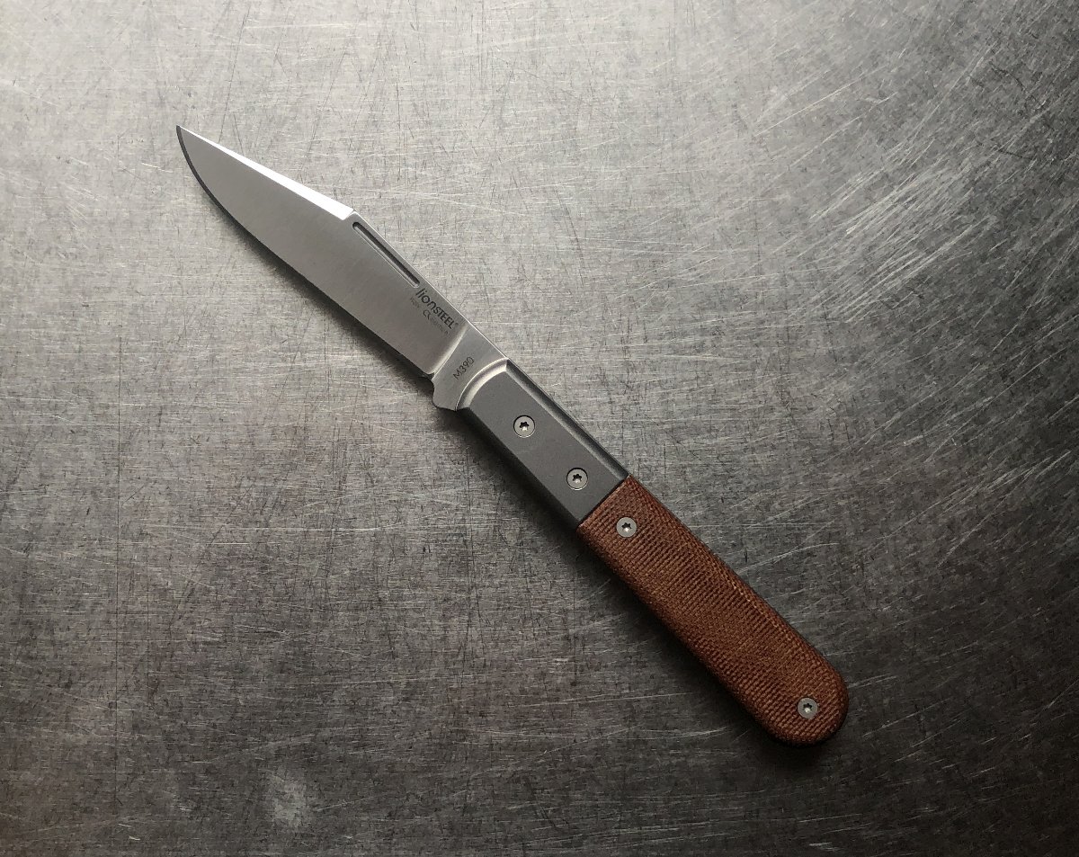

Hi all,
I've got another modern slip joint knife, Lionsteel Shuffler Barlow, since I was so impressed with the construction of their Bolus Otnat.
Mine is directly from the manufacturer, not CK.

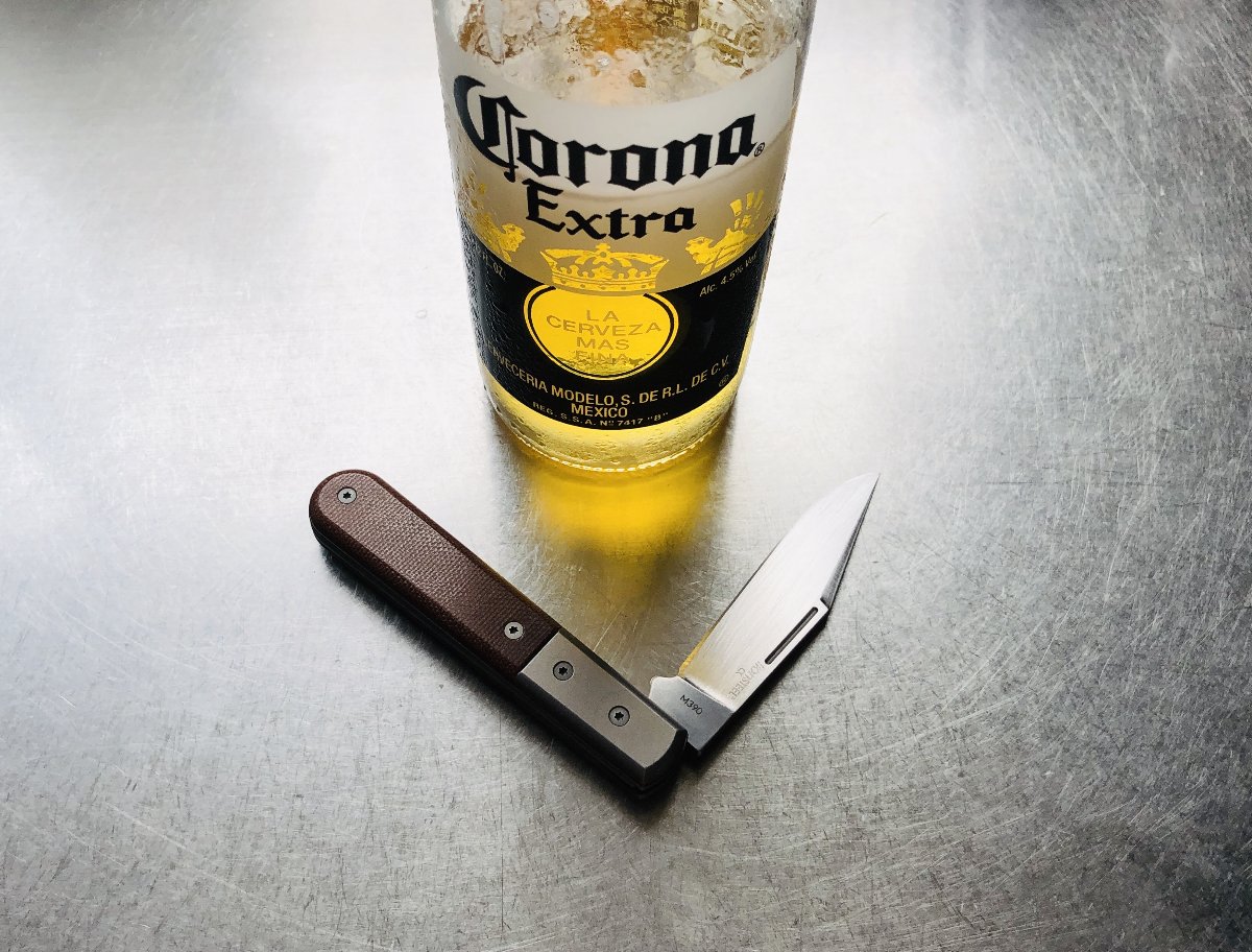

It is a very well constructed knife just like Otnat.
Nice walk and talk.
Good fit and finish.
The only and big complaint about the knife is the blade.
Just too thick behind the edge!

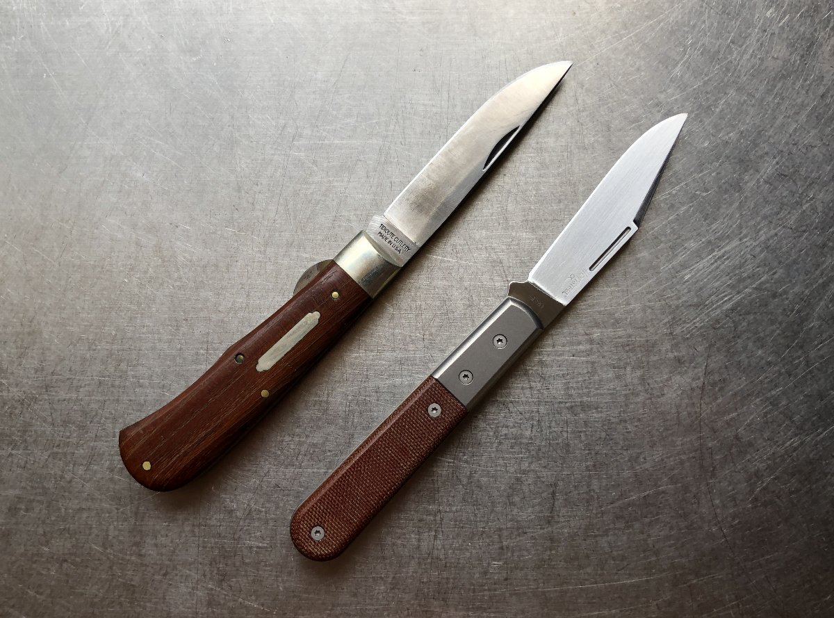

I saw some Youtube reviews and comparisons to the Roundhead.
They all say that Shuffler is better ground and thinner behind the edge than the original Roundhead.
Even though I was intrigued more with the Roundhead blade, I bought Shuffler because of that.

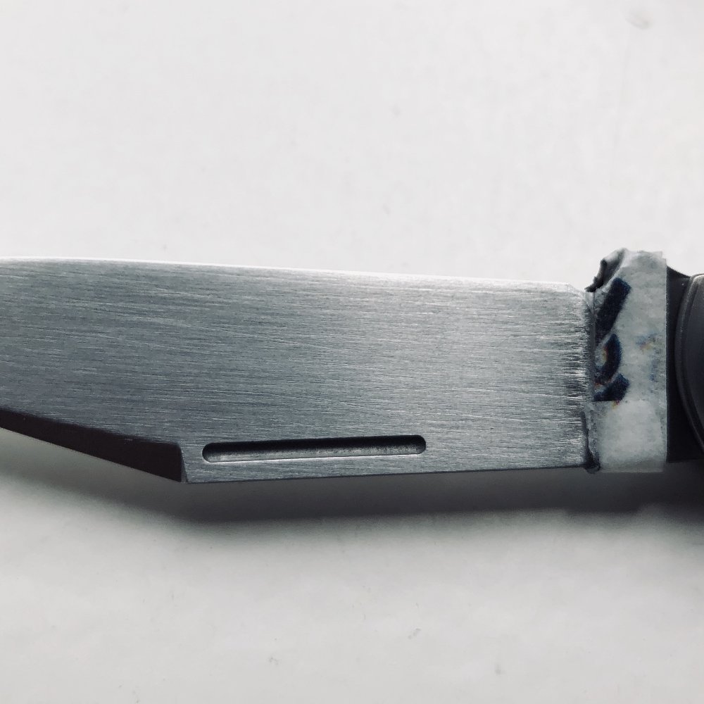

So in desperation, I decided to thin the edge myself.
I took #120 silicon carbide paper and sanded the blade with more pressure toward the edge bevel than to the spine.
After about 40 min, I was able to remove 0.1~0.2 mm layer of metal from each side.
(If you try this, dull the edge first. Otherwise, you would cut yourself deep.)
Then, went up to #180 paper.
The original plan was to polish the blade by going through increasing grits up to #2,000 and then finish with #600 satin.
But at the #180 paper, the scratch pattern looked pretty good, and I was tired.
So I just finished it with #1,000 paper.
After the 1 hour struggle, BTE came down to about 0.01", now comparable to that of Proper.
It cuts really well, like GEC 73, with good edge retention as a bonus.
I am happy with the look of the blade, too.

Thanks for the review. I just picked one up off the exchange, and I'll have to compare the slicing to my GEC #73 Trapper in gator bone soon.
