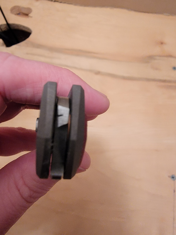

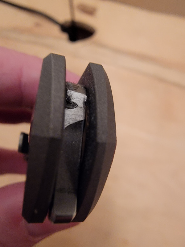

I have an observation and also a question. The following two photos are of the lock face on my new small 31. The first image shows what looks like a wide swath cut by the ceramic ball. The second image shows the same knife after cleaning the lock face. Turns out it was dirty. The ceramic ball is wearing a normal track onto the lock face. I have not had the knife in my pocket enough for the schmutz to have been pocket lint. I suspect it's steel debris, removed by the harder ceramic. My large PJ 31 did the same thing, but it doesn't seem to happen any more. I'm hypothesizing that this is the result of the lock "settling in." Do you guys think that makes sense? Could this be the basis for the user observations that lock flex decreases as the knife breaks in?
I wouldn’t think much wear would accrue at all since one side is 97rc and the other is 61. The titanium is way softer.
I’ve learned that with the ceramic ball interface, the lock bar looks like it has late lock up. But, when you look at the ball tract on the blade, it’s earlier than what the lock bar shows. My 25’s, Inkosi’s are what I consider normal which is around 50/60 %. Now, the Umnumzaan has considerably early lock up, around 30 %
it is normal soiling due to carrying it in your pocket. I have noticed that these blocks remain like this for a long time and do not need adaptations or running in periods. the oldest ceramic sphere I have is a Zaan from 2008 and it's still like when I get there. the dirt you see is probably due to grease, however it tends to attract dirt once saturated with dust it will attract much less dirt.
