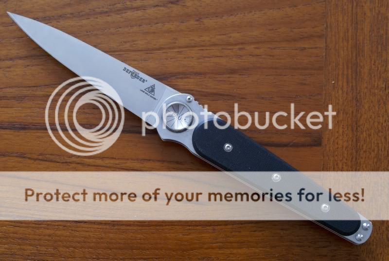

My Defender came with some play as well though it was rather easy to adjust it myself. Vertical play is adjusted by fine tuning the stop pin and side-to-side play by tightening the non-button side of the lock. It's just a matter of careful adjustment, tighten too much and the knife becomes a two handed opener. :)
Rough Edges, what size is that torx screw? And are you saying one side controls play up and down and the other side of the same torx screw controls side to side play. Thanks.
RKH
The screw is a T-5 though I had mistakenly used a T-4 at first. Luckily, I didn't strip it. :o
As for side to side play, that occurs when the button lock loosens up as it tends to do, especially with the "pinch and flip" type of use. As OwE said, it is a very fine thread on the locking ring anad just a minute amount of loosening can cause a bit of play. What I did to fix this is to grip the locking button (for lack of knowledge of the proper terminology) on the side opposite that marked Paul in the photo below and tightened it a very small amount, well under 1/8 of a turn. I found that it really doesn't take much at all to get rid of the side-to-side play, or even to tighten the knife enough to make it a two handed opener for that matter.
As for the vert play, it's as simple as adjusting the stop pin above the button lock until the desired state is reached. It does take a good bit of patience though, at first I actually made mine worse.
For me, the horizontal play is more important and, luckily, it is very easy to fix.

Rough edges and obessed with edges THANK YOU SO MUCH for your kind and informative information. I spoke with Doug Hutchison at Lone Wolf and he said it was a T5 torx. Very nice guy. They took the play out of my Prankster and did not even charge for return postage. BTW, Doug said the reason Gerber discontinued the 2nd generation Paul knife was due to the fact there supplier raised prices on the parts for the Paul lock. Thank you gentleman for all your comments.

As for side to side play, that occurs when the button lock loosens up as it tends to do, especially with the "pinch and flip" type of use. As OwE said, it is a very fine thread on the locking ring anad just a minute amount of loosening can cause a bit of play. What I did to fix this is to grip the locking button (for lack of knowledge of the proper terminology) on the side marked Paul in the photo below and tightened it a very small amount, well under 1/8 of a turn. I found that it really doesn't take much at all to get rid of the side-to-side play, or even to tighten the knife enough to make it a two handed opener for that matter.
That's essentially what I found, although making it stay tight was the real problem for me (hence the glue).
