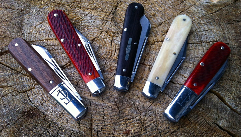

So these have been out for a while now. Could someone give me some insight on how well they hold up and also how dificult can it be to maintain the 1095 steel liners from rusting? I would also love to see some overall pictures of a well used boys knife (or charlow). I am contemplating a boys knife but I have never owned a knife without brass liners (or stainless).

Here's mine after some months of use. The blade and bolster have stained a bit, but no rust. A drop of mineral oil in the joint weekly goes well, and I just wipe the blade down each evening. No problems so far.
