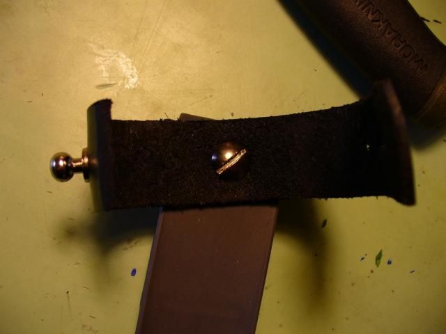

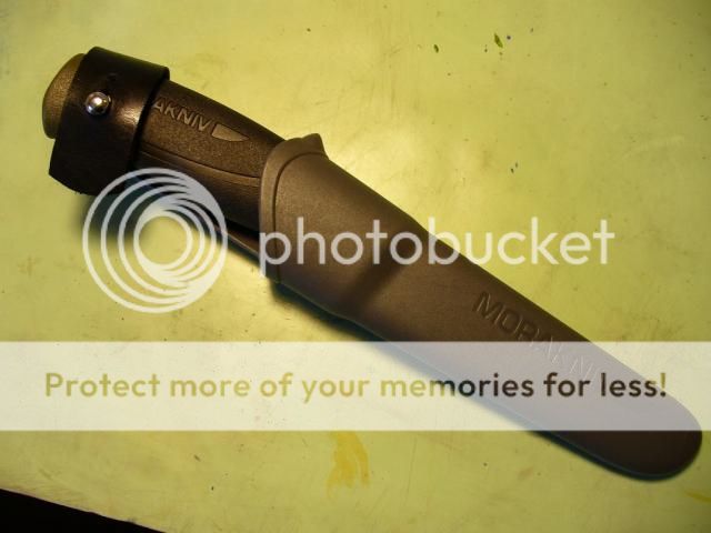

It is pretty simple to retain the Companions. Lay the para across the front of the knife grip, take both end and cross them at the back, pull up under the belt clip, put one of those spring loaded retainers on the ends (can never remember what the darn things are called), snug para then slide clip down. Works like the cats meow. To release, squeeze retainer and pull up on tail ends, pull loop off of knife. The more you use the set up the looser\smoother the para becomes.

Just got a great idea from the pictures above though, thanks.
