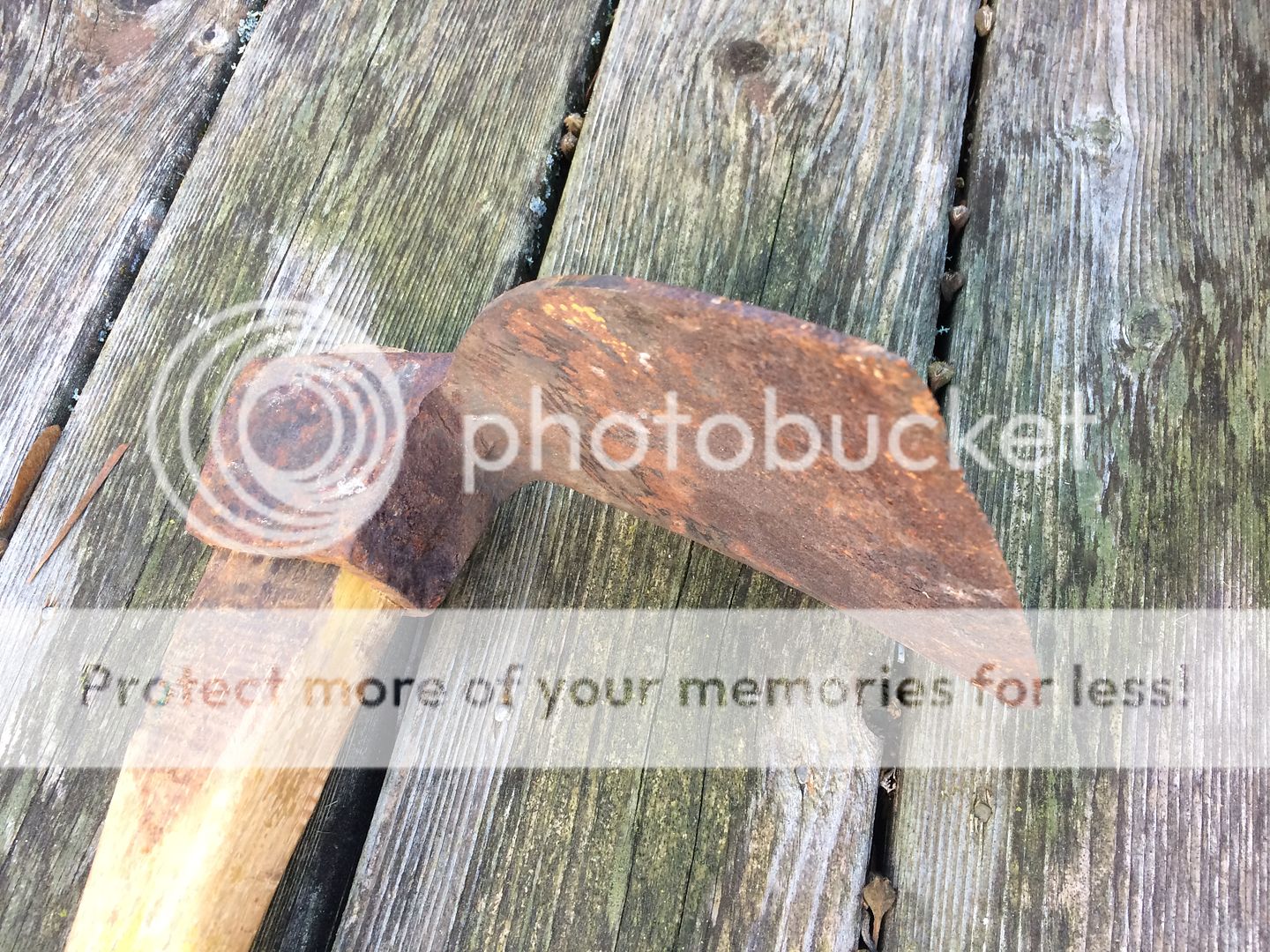

I've found that the square eye (Adze/English?) grub hoes used for fire/trail work to be handy.
My brother and I made quick work with them. He's a pipe-fitter so he got to supervise for the most part. I don't feel bad about loaning them to my neighbors either.
They can move a lot of earth but don't replace a good shovel (have to scoop and remove what you don't use as back-fill)
There are a lot of models but I often find them here for less than the cost of a replacement handle. Some have markings but I haven't really taken the time to clean them up beyond not dropping dirt on the shed floor.
Here is an example - not the best photo:
