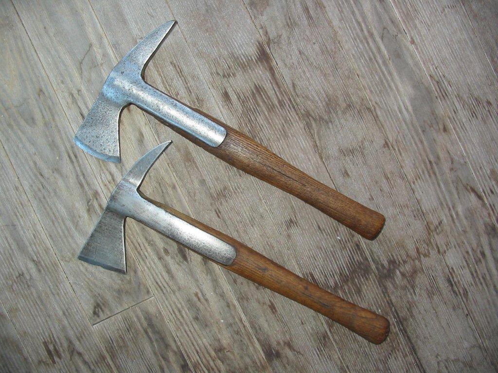

I appreciate all the information. Here is a picture of a few different boarding or firemans type hatchets that I own for some size comparisons. I believe the one's I have pictured here are very similar to the one's noted above as far as size and design go. I'm not sure what the correct terminology is, but on the hatchet in question, the steel extends down the handle quite a bit longer than the others, and every part of he hatchet is larger in any measurement you take. It feels much larger, and heavier in the hands than any example I've handled in the past. The detail that has thrown me off the most, is that I haven't seen another firemans hatchet or boarding hatchet that has 3 pins in the handle... all have 2 like the examples you all have shared.
