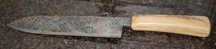

In my experience with making & using three 15N20 steel (commonly use for band saw) blades, I found a micro bevel (34* inclusive) would double edge retention in compare to 24*. Your knife blade is FFG + tall + highly polish, all add to poor food release on the upper part. Here is a thin 15N20 12cm petty I made for a friend a couple months back, where its hammer finish does help with the food release
edit: 22cm gyuto
Devin Thomas- Saw blade is 15n20 or 15n2 which is the same thing. L6 has chrome and a splash of moly in it along with 2% nickel. 15N20 has 2% nickel. L6 is a tool and die steel and 15N20 is made for saws. A little different.
i would assume he would know his stuff haha but im assuming your are correct on the 15N20.
I will try the microbevel and see if it helps at all, i have found using my strop day to day i can prolong the life but eventually the edge will not come back.
