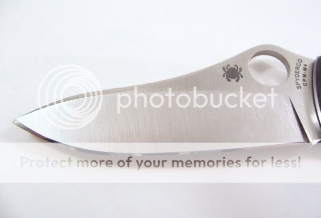

I had intended on reprofiling my Spyderco Gayle Bradley but I wasn't sure how shallow I wanted to go. I ended up going about a hair under 15 degrees per side (eyeballing it, freehand can't be exact IMO). It now cuts absolutely amazingly. What I was really surprised at was how easy it sharpened, I was expecting it to put up a much bigger fight. DMT stones working my way up to .25 diamond on MDF, as close to a mirror as one can get. I think the worst part of it was when I got up to the first set of stropping, I noticed some scratches I missed and had to go nearly all the way back. There was really no real reason to do so, but I figured why not? Still my favorite knife.
I've tried every method of sharpening in my quest for the best edge, edge pro (sold within a week), paper wheels (quick sharp edge, but could get a MUCH better edge other ways) belt sanders and stones. My two prefered methods are my kalamazoo 1x42 grinder for my bigger blades and DMT stones and diamond compound for smaller blades.
when i saw the pic i thought to myself, "great...another edge pro blah blah"...but then i read it's all freehand...very impressive! nothing wrong with edge pro though. i might buy one in a few weeks time but freehanding somehow relaxes me.

I won't knock the EP, it just wasn't for me. I enjoy free handing, both with stones and belt sanders. Too many jigs/contraptions just aren't my thing. I used to convex everytihng, but to be honest grinding on smaller pocket knives is a lot harder than larger fixed blades so now all my folders get hit with the stones then stropped. The izula and lawman got a similar treatment last week, thinned them out decently, I had to take the lawman a little thicker though, the edge was flattening a bit.
Great looking edge 230grains:thumbup: I used my DMT stones on mine as well was surprised just how easy M4 was to sharpen. I'm starting to think you could sharpen a rock into a mirror with them.:D I tried to stay as close to the factory edge as possible.

Nice work 230, yeah M4 is not bad with the right tools and seems to beg for a high polished edge :)

What did you end up finishing with? Edge looks great.
