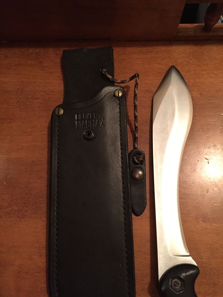

Anyway, I have been very busy with machax related projects this summer. When I was at the gathering my new favorite mod derekH gave me an original becker machax sheath to go on my warrior machax. That sheath is awesome! I don't know if Ethan designed it or someone else but it works great! The straps on the back work great for belt carry or MOLLE. I liked this sheath so much I wanted another for one of my users.

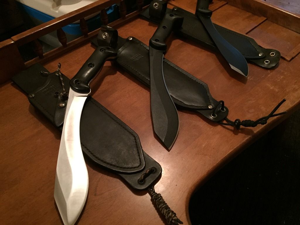

So I made one: and it sucked. Made another. It was ok. Made one last one and I messed up the stamping a bit, but it's fine (I've never been a patient craftsmen or even a craftsmen for that matter). I don't know what happened to me, but I was hit with the biggest OCD attack ever.
Well, I did get two useable sheaths out of it (and one really crappy one that I'm not going to show you haha).
Now I have three generations of machax all in matching sheaths.

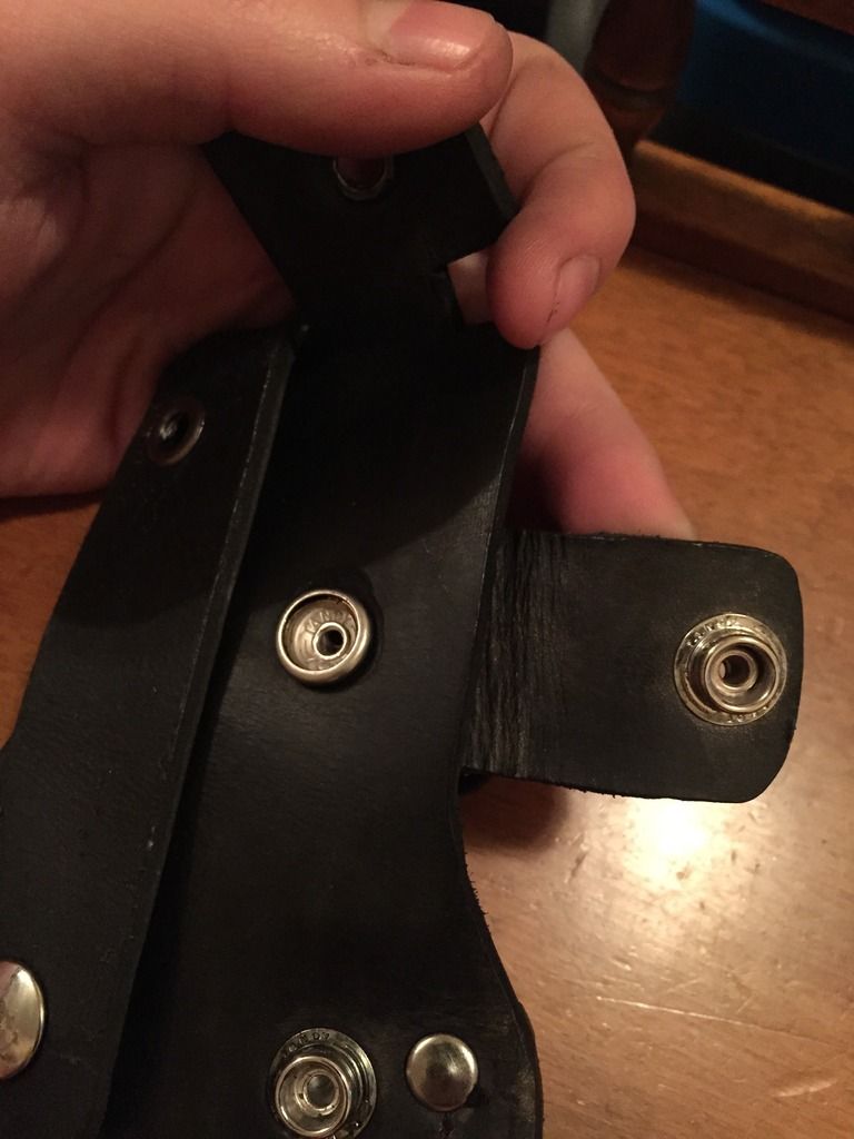

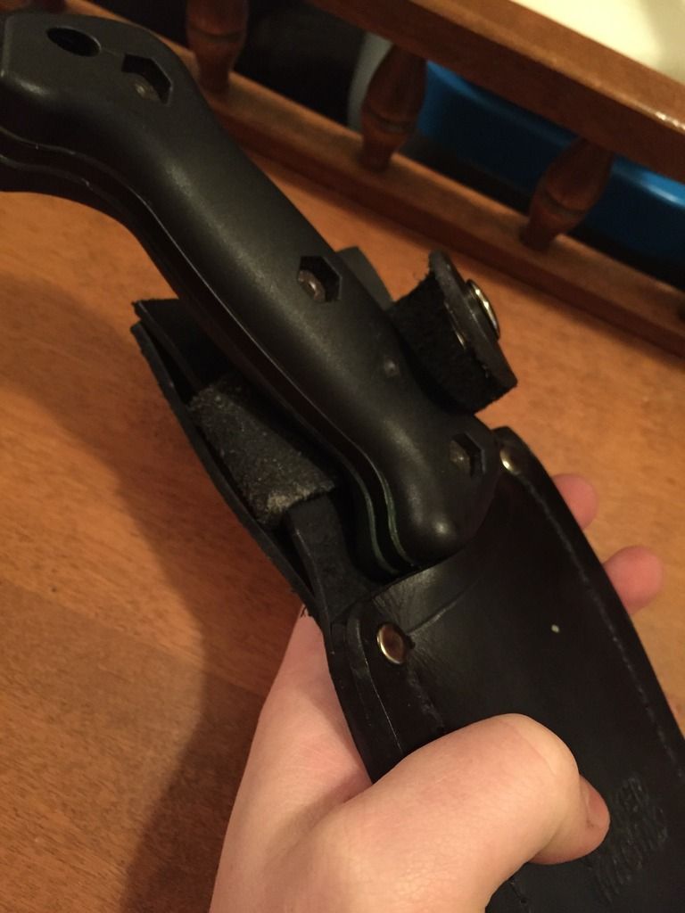

I did make some changes to the retention strap. I love the original paracod loop method the old sheath has but I really wanted a leather strap on the new sheaths. Because I had to have a leather strap I had to add a new feature so I wouldn't cut the strap taking the blade out like I do on the kabar sheaths. The pin that holds the strap on is actually a snap so you can fold the strap behind the sheath. I just leave it folded and snapped when I use it. The sheath holds it in just fine and I can pull it out and put it back a thousand times without cutting the strap.

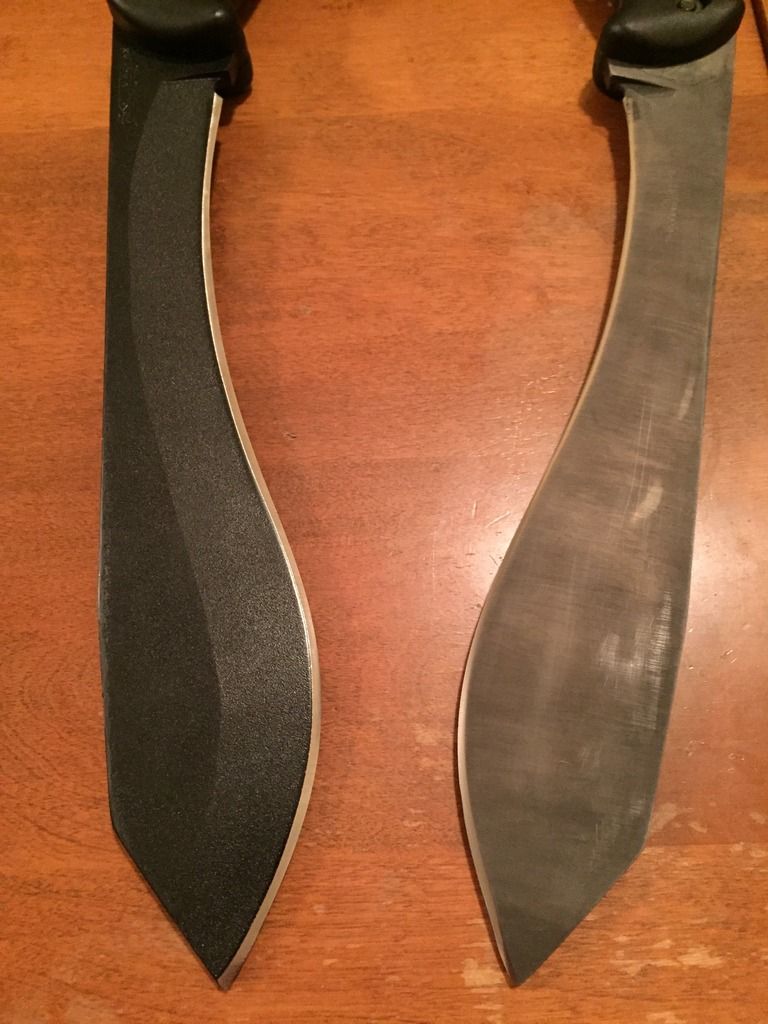

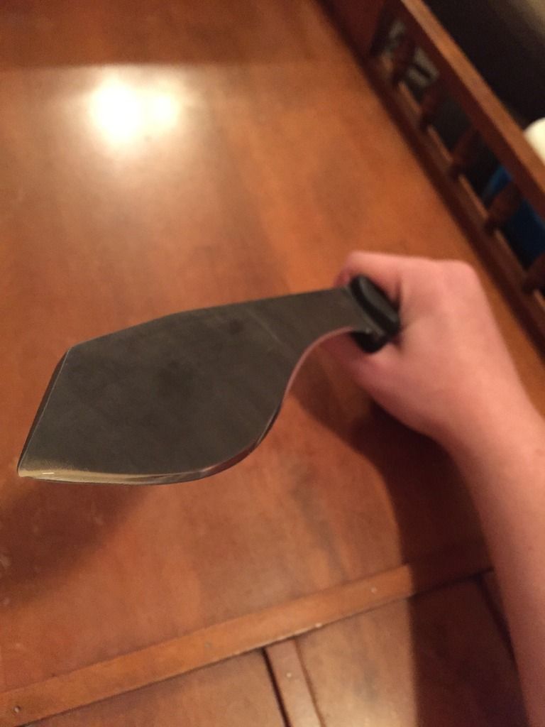

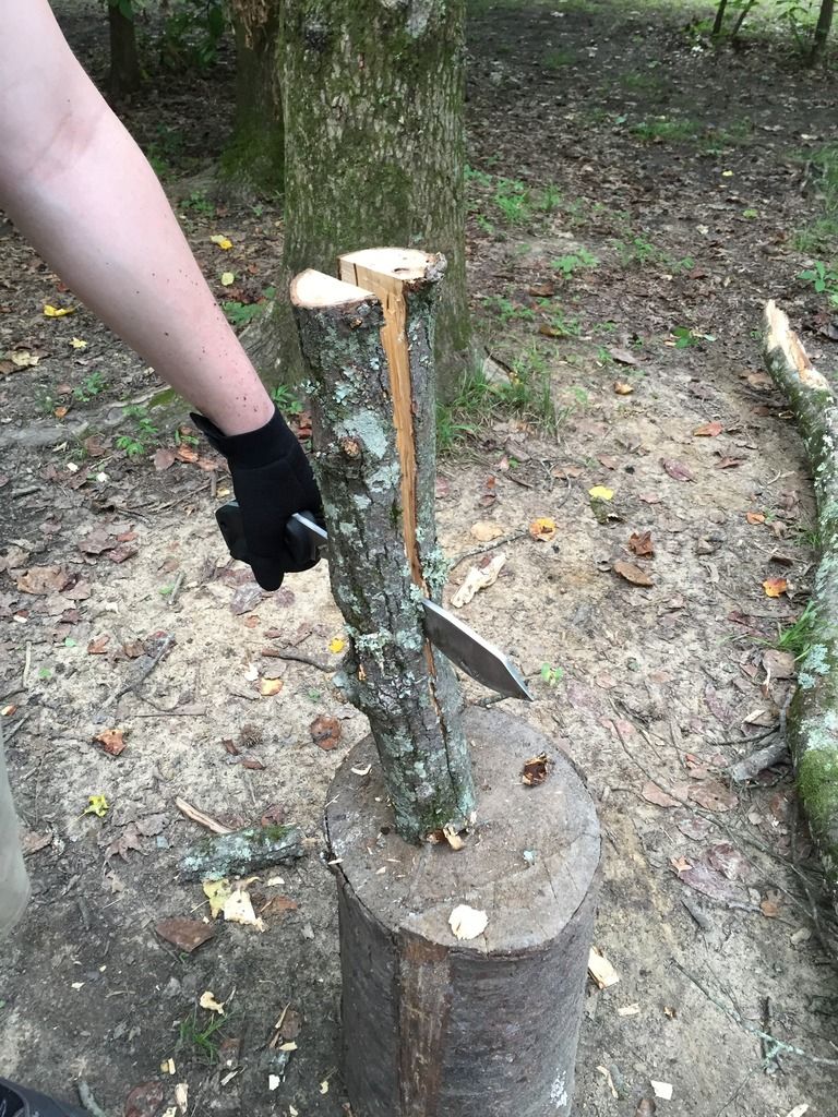

Now my latest project involves a camillus machax that I've had for a while. When I got it the condition was less than subpar. Incase anyone doesn't know the cam machax is the worst version. The .25" thickness and bad grind angles combine to make it not a fun tool to use. So I wanted to fix that. After a few hours on the belt grinder this new convex machax is one bad mofo! It's almost a full convex, but I did add a slight secondary convex edge to it. I failed to get any photos of the process or good glamour shots afterwards.
It's still a bit too heavy and too thick (like my ex), but it slices now! It's about 20oz now, the weight on my stock camillus is around 22oz so I took off roughly 2oz.

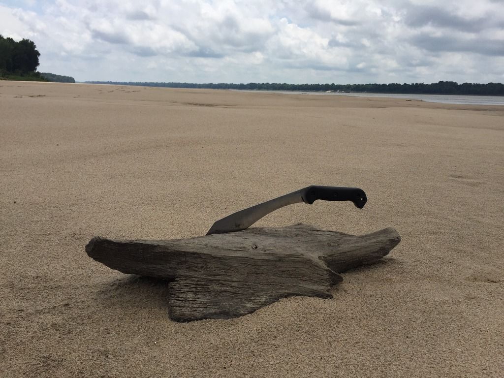

Just got back from camping yesterday. Went out to a small place north of Memphis on the mighty Mississippi River. It was not the best time to test the new blade, we got rained out. Spent most of the time in the van playing cards. Weather cleared the next day and I got to take it out and do the usual camp tasks with it. Chops like a dream, splits wood even better. Even made a descent feather stick with it.

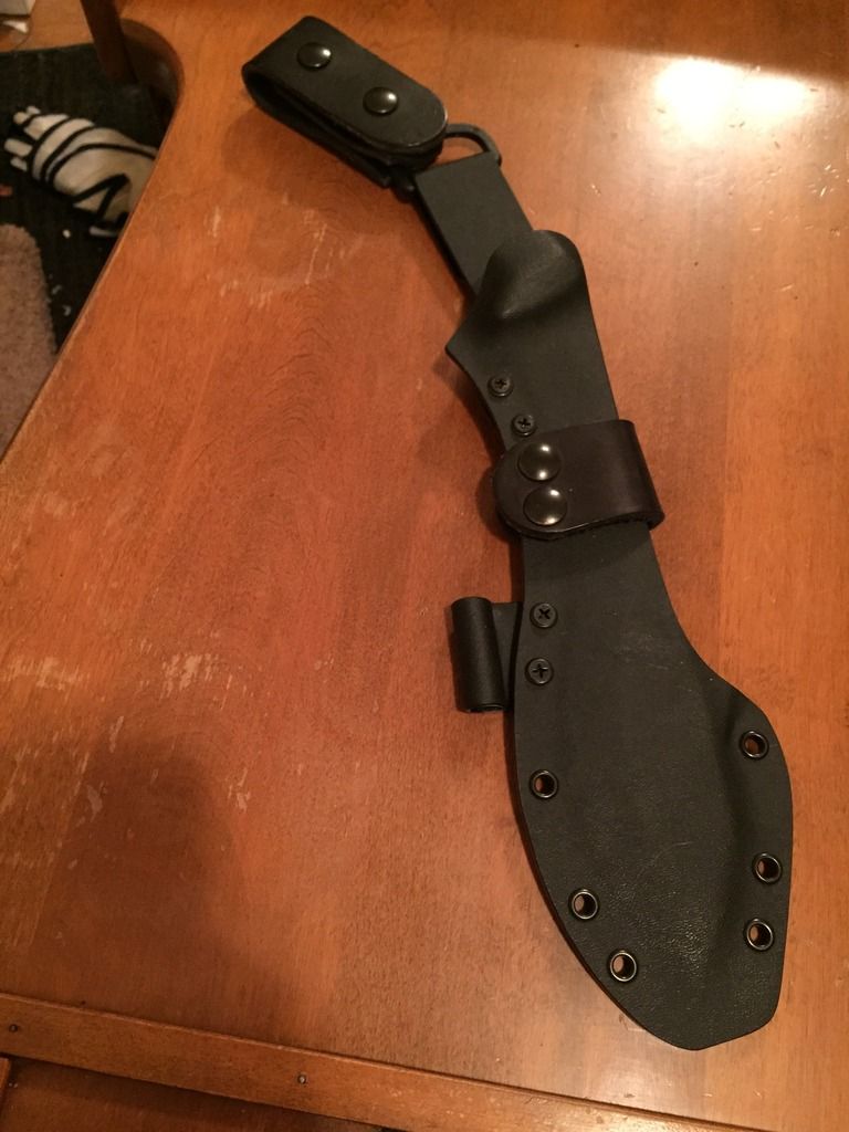

It's now time for the giveaway portion of this thread. I'm giving away a 710 kydex sheath for the machax. It's an open spine dangler sheath that fits the stock kabar machax.

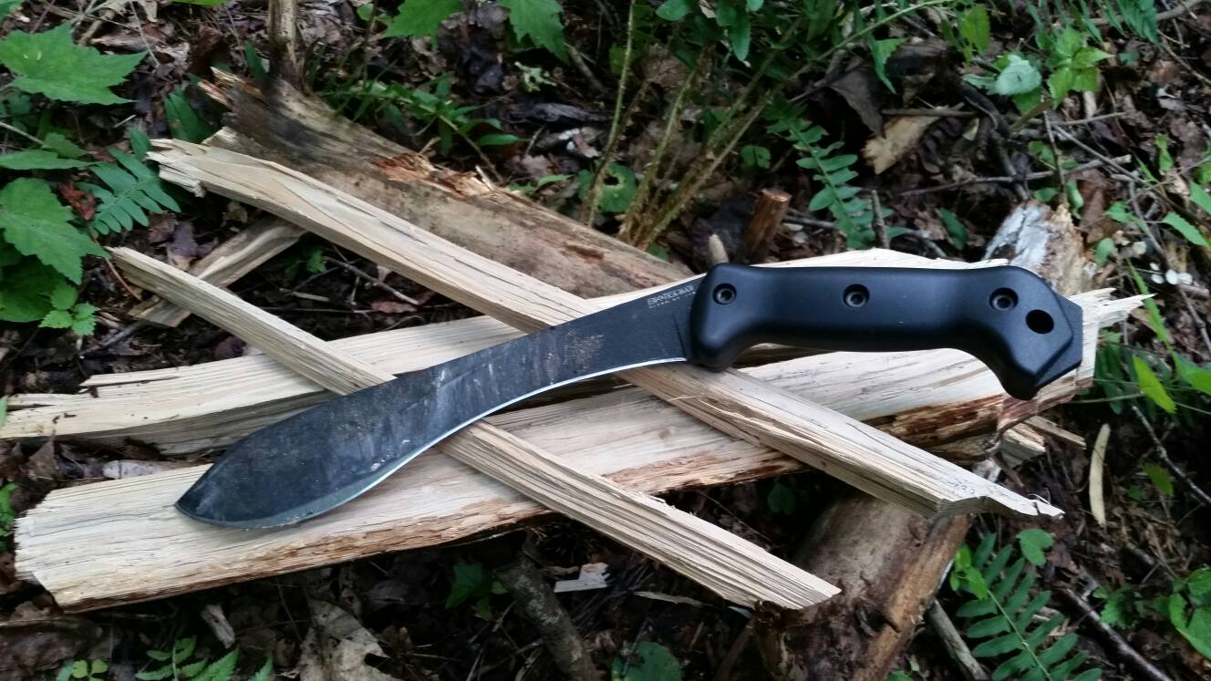

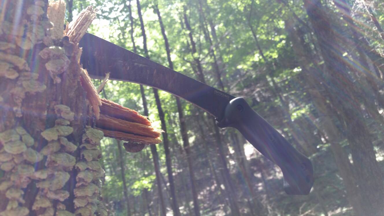

Love the machax. My favorite big knife I've ever used. Here's some pics of mine I took just yesterday.
I still have the factory sheath, and could benefit from the chance at an upgrade. Thank you for your generosity!

Very good idea placing the button behind the sheath holding the strap back.

Nice job on the sheaths.

if you look close on the original leather sheath, it should have a makers name on it. i don't recall who. Ethan knows though.

The really cool Machax sheath was designed by me and made by Gary Brommeland...... He does very nice leather holsters.... Those sheaths were made from 10oz" English tanned" leather and all mil spec hardware, even the eyelets. Gary's work is second to none.....
Those are some good looking sheaths KJ!
