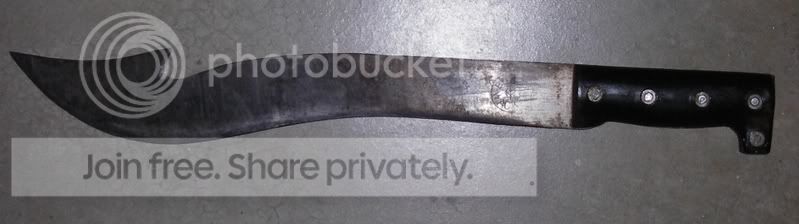

Had the one below for the past 3 or 4 decades and had little use for it for most of them. That's no longer true. Been using it a lot this last week hacking a path in very thick brush wide enough for a Farmall with a bush hog to pass through. [Making a private jogging/hunting trail that can be mowed/bushogged as needed.] A real good work out for the elbows and shoulders. Not really that noticeable in the first hour or two, but by hour 5, you feel it. Anyway, I have several blades, but like this type as often felled trees are covered with Kudzu and the hook handles the vines nicely so the trees can be cut free and hauled out. Problem I am feeling most is in the handle. Does anyone still make this type but with a more cushioned handle? I see the new Ontario handles on their machetes, but their blades lack the hook. I was hoping CS made one, but no luck there either..

I am not sure that a five hour stint with any machete is going to feel good on your paws, but you could try to use a gardening glove. The rivets on your handle look like they could be buffed out a bit or smoothed over with a file. I have reprofiled most of my machete handles on my older 18 inch Ontarios, and they feel good in the hand.
That's a good design that I've never seen before. I'd keep on using it is if is effective for kudzu-taming.
I think that you just need to re-handle it. Either remove the grips and replace with some wood, micarta or hard rubber material like you can cut from a truck tire, -or you can reprofile it with beltsander, files and high-grit sandpaper.
You can also soften the grip a bit by wrapping it with foam tape.
If that blade is working for you, go down to Wallyworld and get some bicycle handle tape in the toy section. It is a cheap and quick fix.
-Mb
You might try cutting large rubber bands from a bicycle tire and stretching them over the handle. I did that with one of mine years ago and have really come to prefer it. It provides a bit of cushioning without decreasing the "grippiness."
Sad to hear Bushwacks are no longer made. I did look at Condor's machetes and also Woodsman's Pal and some other brands. I like this one.
I am in total agreement that the handle is the problem. The rivets and their washers are slightly recessed, so it isn't 'rivet bite' that tears my hand up. [It is too hot on an 80 - 90 degree day to wear gloves all day. I don't really mind (too much) the occasional blood when the berry bushes bite back (some of the older ones have thorns well over an inch long and an eighth to a quarter wide), but my palm does take a bruising from the repeated shocks when chopping.] Most of the back bite shock comes while chopping stumps to be low enough to just drive over with the tractor (it's anticipated the bush hog will do the rest). The machete handle's tail does most of the hand damage as the handle tends to spin a little in my grip on the awkward angle chops. A cutlass grip like the Ontarios looks practical as a means of not dropping the blade (happens sometimes), and their day-glo color is well understood. Really wish they came with a back hook.. I suspect the bicycle tube fix will be the best short term fix for this one. Thanks for that. New grips are definitely in the plans. Danke.

Both writers (who are well known) find the shape of the grip to be very important for control and reduction of fatigue. After reviewing the (many) articles surrounding the thread I have decided that in addition to new grips, a reshaping of the Bushwack grip is probably in order.
