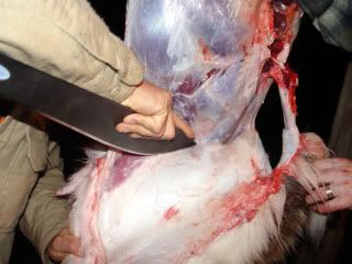

The only butchering I've done in Brazil has been hogs and always in a village setting. The first time I delivered the first cut with a USMC Ka-bar to the heart and the pig bled out really fast. The rest of the work was done by normal kitchen/butcher knives.
The last time I was in that village at hog killing time I happened to have a bag full of moras that I use for teaching bushcraft workshops at our camp. I brought them over and everyone took to them like ants to sugar. In fact one of them got taken home and I had to go after it across the village.
The pig is split down the belly.
They use an axe to cut through the ribs along the spine but a machete would work fine for that.
The pig is basically boned out with the small knives, cooked on the spot and the meat preserved in it’s own fat without refrigeration.

Butchering with a machete isn’t too hard provided you know what you are doing originally. I wouldn’t go into a deer per say, for the first time, with an 18” machete. But after a while you learn to work with a lot of stuff, and somewhere along the line you may find yourself picking up a machete or two just to try it. A buddy of mine, Keith, used a 18” to skin a catfish. Jeff used a machete to go after caiman and then butcher it. The South Americans think nothing of using a machete partly because its right there next to them. I’ve used a machete before to skin out a deer. It can be done easily if you know what you are going for, and for the head, etc, you need to feel for spots in between the neck vertebrae. You can also just go gung ho and hack at the neck area, but it gets tricking going after the backstraps. I’ve only done it a few times and the twist method also works. Choking up on the machete blade and putting the handle in your arm pit helps. It is just like anything else though, experience and working with what you have yield the best results.
These are the only pictures I have :(
