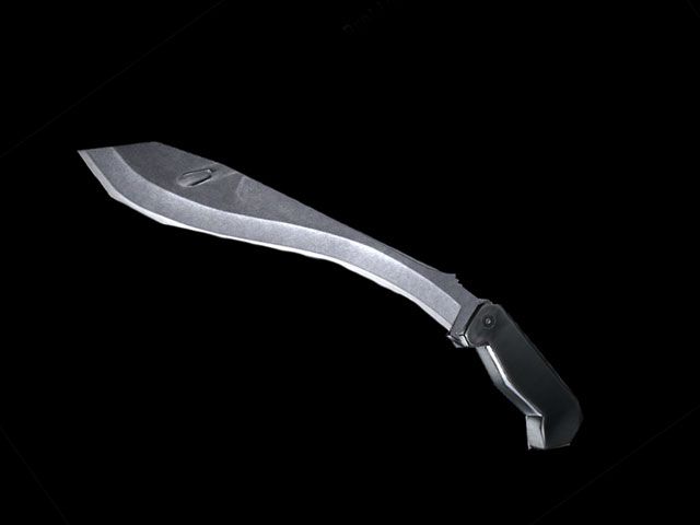

Hi Michael,
Something like this done your way would be appropriate.
[IMG[/IMG]
Is that a Becker khukri model from Far Cry?
