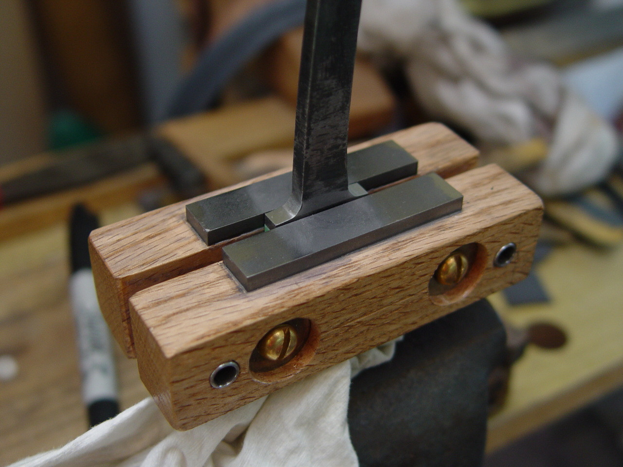

I made this several years ago as a mockup to test a couple of ideas. It worked surprisingly well so that I stopped chasing a steel or aluminum version.
The base material is local air-dried Red Oak some decades old. It was prepped as a single unit. Squared and drilled for guide rods and screws with the two beams temporarily glued with a piece of paper in between. The carbide strips came from MSC for about $22 back then; they carry about any spec you would want.
The screws running through the beams are captured by steel T-nuts on the backside. I managed to get the carbide inserts in plane by setting them side by side on a surface plate, buttering both strips and beams with JB Weld then setting weighted assembly to cure upside down on plate. I assumed it would be necessary to flatten afterwards but got corner-to-corner scratches within a dozen or so strokes on 120 DMT plate.
Yeah it looks a little Fred Flintstone, and yeah you have to shim it if your contact areas aren't parallel but I have seen that some top quality guides (Uncle Al, Bump and Benhke) flex and will need some shimming too if they're cranked down tight on non-parallel surfaces (Nick W has a great visual on dealing with this in his "Stuck on the Metal" thread). In the end, the thing is better than I am when used thoughtfully and has served me well for some years. I use both safe-edged files and grinder against the carbide and it couldn't care less. It is maybe a little bit shiny in the wear areas, but when I clamp up a small surface ground piece of stock and go to the diamond plate, it still comes up flat with a uniform scratch pattern after several years of use. I use it for more than just shoulders and it has saved my bacon several times. Maybe not ideal, but I like making/using my own stuff and it's not even close to my biggest bottleneck as a maker.

Andy - you did a GREAT job!!! Those carbide could be set in wood, or in metal either one. After all, it's the carbide that takes the brunt of filling/grinding stress. Good job! I've been planning to get some carbide strips and make a file guide, but I've got a couple of Fred's bubble jig clamps that work like a champ as a file guide.

I used steel and not having the carbide strips i placed 2 square carbide lathe's bit for jaw. Of course the carbide bits have an hole in the center but it is irrelevant. Needless to say it needs to glue the carbide bit with the flat face on the outside ;) The opposite face groove gives epoxy a better surface to grip btw.
The diamond plate is necessary to flatten the faces if it's needed.
