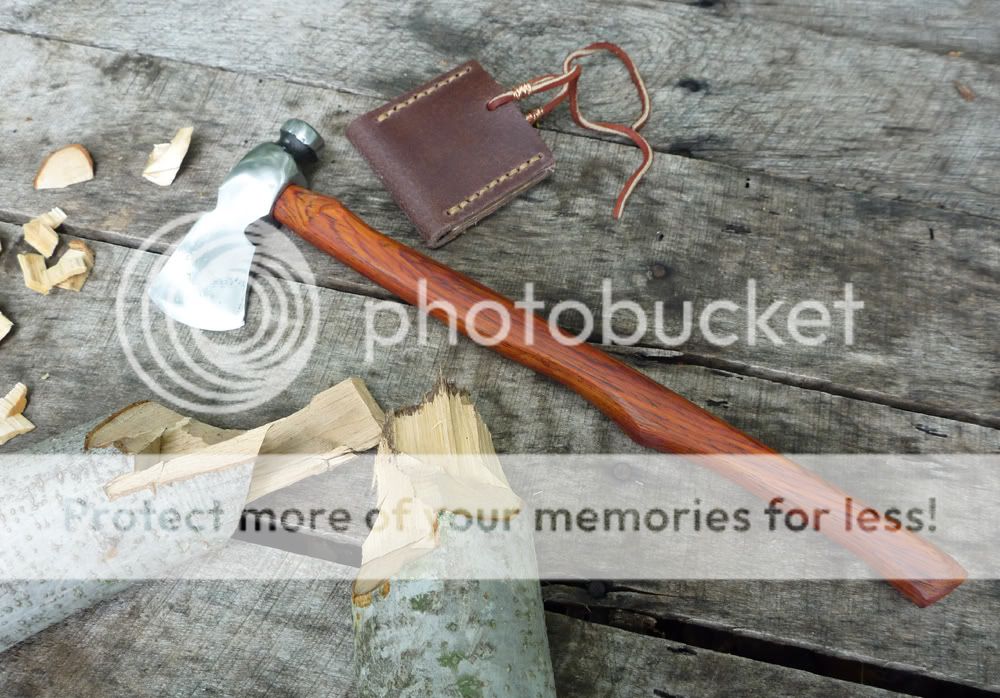

These are all made from 5/32nd circular sawmill blade about 100 yeas old. Some say it L6 other say it usually isn't. The stuff is touch as hell.
Regards
Robin
[/url][/IMG]
[/url][/IMG]
[/url][/IMG]
[/url][/IMG]
I haven't tried a saw blade yet.
I usually forge them from old ball-pein hammers and they turn out nice. Fit right in you back jeans pocket.
How did you plan on using the steel? As a bit, in a forge weld hawk head? Or, like Pipeman's hawk? If it's thin like Pipeman's, then I just can't imagine there's enough weight to cause lots of impact. And, used as the bit, it should also be fine, when surrounded by a tougher steel. I'm no expert, but Kentucky uses L6 for bits on lots of hawks.
