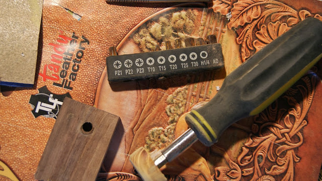

1.Getting the hole
So first you take your block of wood, in this case w3alunt6 form my scrap tub
Then I drill a hole in it, I use a 1/4" bit and often work a second circle in around the end very carefully with the drill bit while ti rotates to make threading lanyards through ti easier. i find this size just, only just, big enough to fit regular leather lace lanyards through.
I then use a coping saw to cut out around the hole, i try to make it as round as possible but it's more important not to cut to close to the hole, making it to thin is worse because, as always, you can't add any wood back on
2. Rough shape

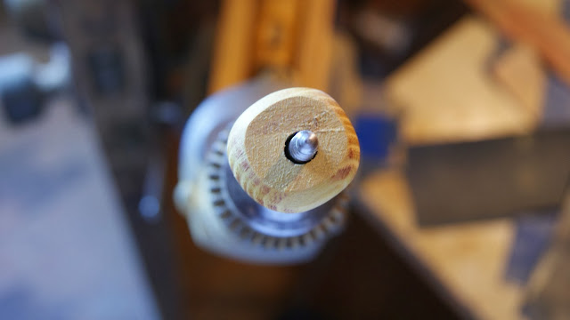

Then I grab a screw driver with replaceable head. you can use a rod, or any other tool you can work into the hole that allows you to get a good grip. I had an extra set of screwdriver bits for these type of interchangeable handle/screwdriver sets and decided to modify the end of a few to fit different hole sizes. I was using a large metal dowel rod but ti hurt to keep a hold of it for too long and turn on the sanding disc so i came up with this.
I then clamp my drill in the vice and my sanding disc pad in the drill and put a 60 grit sanding disc in place. I've found 60 to offer the best speed to quality ratio for this, much lower and it cuts to fast to work with and high it takes to long.
At this point I'm not trying to get the bead very smooth, just the basic shape, I normally aim for just a round shape but have tried more angled or "fancy" styles. The main thing to keep in mind is the edges will look rough and lumpy when finished, just get the thing in rough shape.

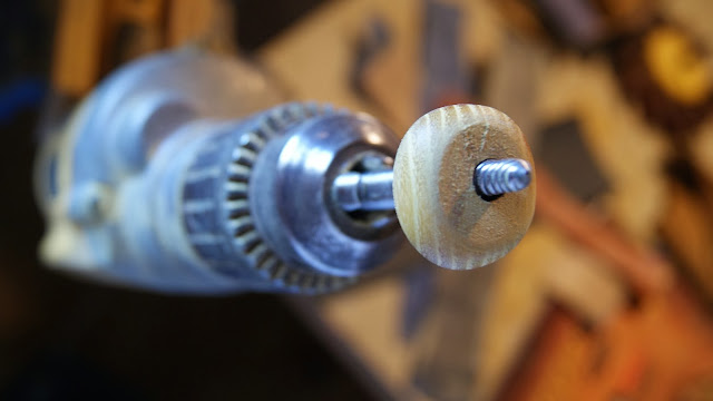

3. Finish shaping and sanding
For this part I use a (appropriate sized, in this case 1/4") cheap set of screw removers (available on ebay or any auto parts/DIY store for less the $5). never had any luck getting them to pull a board out screw but they do let em counter screw the bead on to it so it doesn't spin off while the drill turns and I apply pressure with some sanding paper strips.
I have these sanding strips cut off for sanding knife handles up to 600 grit, I save the ones that start to lose there bit or are just left over after a handle and use them for this. They are just sanding paper that have painters tape o the back, then i cut them to a strip, makes shoeshine sanding easier and the sandpaper last longer.
I start out at 100 and work through the grits up to 600. BUT the most important part is the 100 grit stage this is where you spend the time, getting the bead smooth and to shape how you like.. (You can also hold a file up to the bead at this stage if you want to get a little more detailed in your design on the bead) It's a very simple, partial lathe, if you like.
Again i use both hands - i don't' recommend forgetting that, it'll eat your fingers up
- but I'm holding a camera instead. Make sure you don't forget the other side to, you can stop the drill and turn it around or just reposition the sandpaper next to the shaft, I've started doing that more often as I've gotten confident with it.
Anyway, after I've got it shaped how I like it I do the same with the other grits from 100 - 220 - 320 - 400 - 600, then I give it a coat of linseed oil.it's worth investing in, I bought this can about 4 years ago, have made a lot of knife handles and beads and such since and still haven't ht the half way mark (I use a lot of walnut to and it's a thirsty wood!). It's available from walmart or about anywhere else that sells sand paper.
