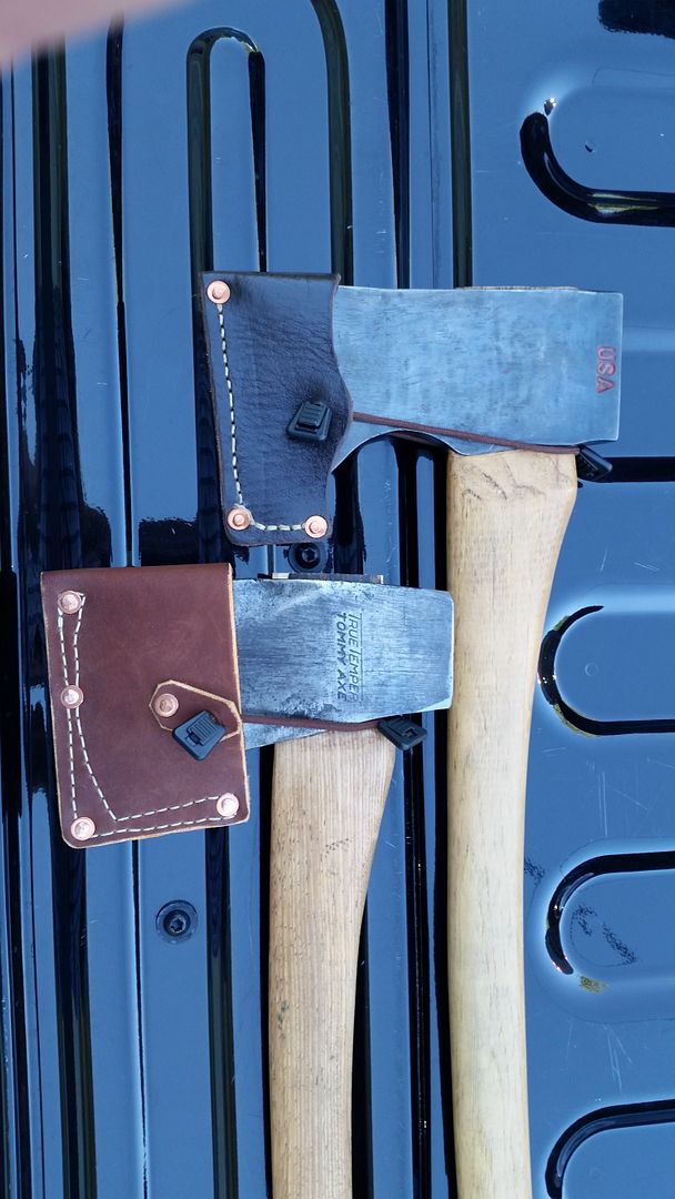

All of my supplies came from Tandy Leather. I'm a hobbyist. These you see are the best I've done and could be done significantly better. I have a lot more practice to do but they function well and keep the edges protected.

Nice work and just the sort of info I was looking for...I was even thinking if I had the leather pattern cut and ready maybe a leather boot repair shop would stitch it for a small fee and then I could add the rivets and a snap.Something now to work on for sure.

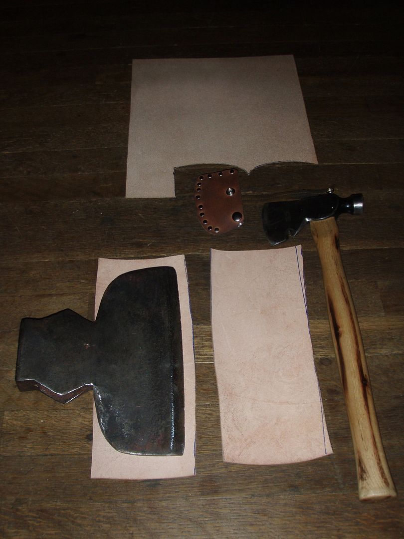

These are some scrap leather from hobby lobby. The copper 2 pc rivets are off amazon and I used some heavy waxed thread and leather sewing needles for the stitches. It helps a ton if you use a drill press and drill holes for the stitches.

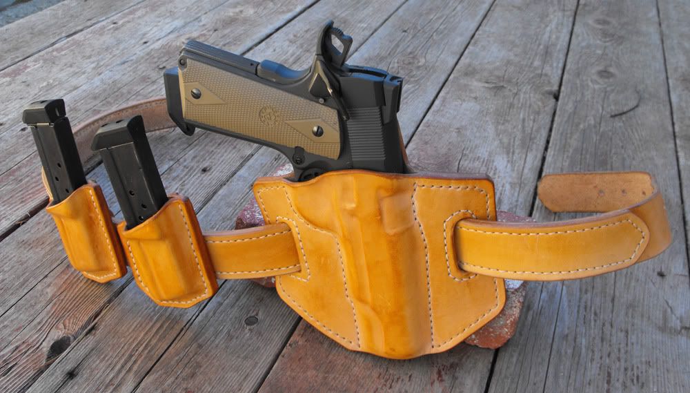

This is going WAY back but I made this entire set with belly leather. Would it work for a pro leather crafter? Nah. But it worked ok for me. That's all hand stitched with an awl and waxed thread.
