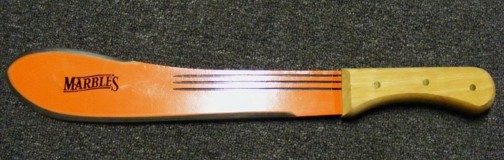

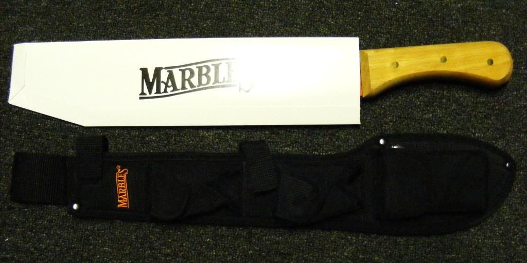

I have a rather picky attitude when it comes to machetes, and this alone prevented me from getting a Marble's machete for quite a few months. This ugly, orange-colored thing first caught my attention in a Smokey Mountain Knife Works catalog, and I decided to give it a try. The one I'm reviewing today is the Bolo machete, model MR33514. It's also available with a "normal" 18" machete blade and an 8-1/2" long cleaver-style blade shape. Each machete costs about $8 with the sheath being another $8. However, SMKW sells the machete / sheath combo for $15. The sheath is made in China, and the machete is made in El Salvador by Imacasa.

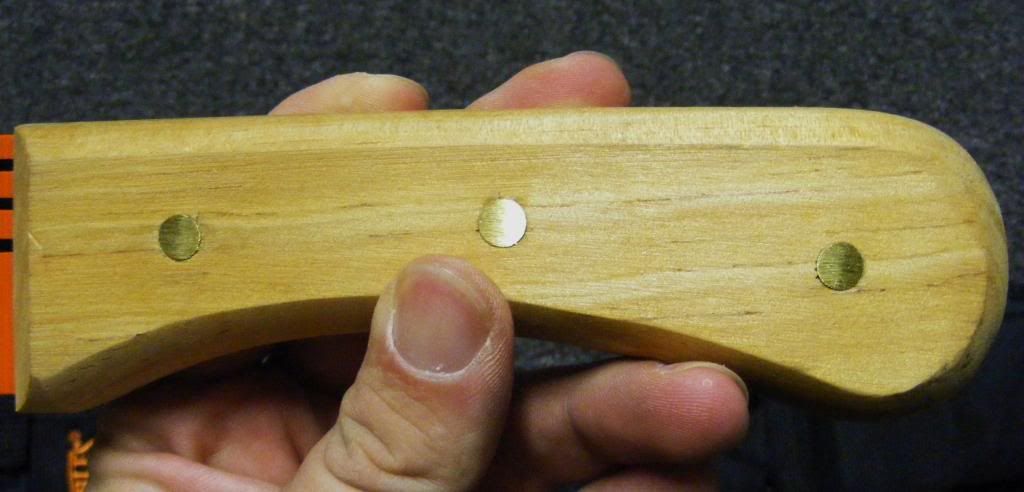

The Handle: The Bolo has a sanded (but not laquered) pine handle, secured by three brass pins. The handle is 6-1/4" long and 1-1/16" thick.
The handle is a nice fit in my hand (I wear a size XL glove) and the fully exposed tang gives it a nice weight. The balance is about 3" ahead of the handle.

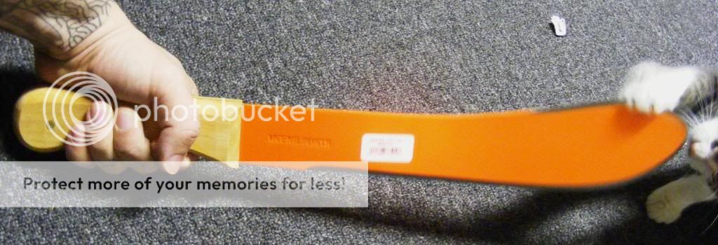

As you can see, the cat likes the orange finish...

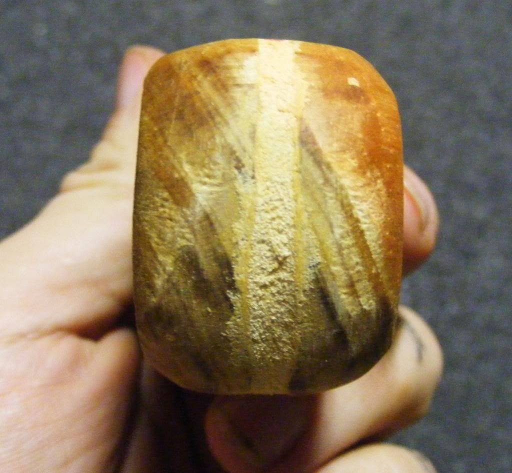

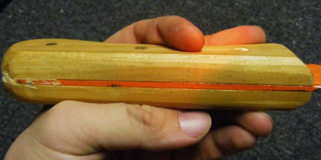

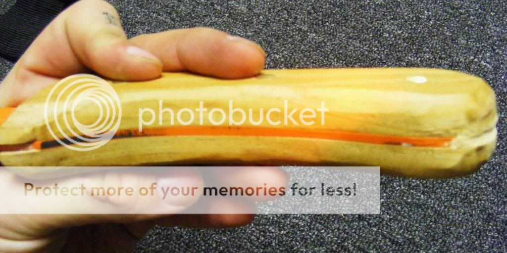

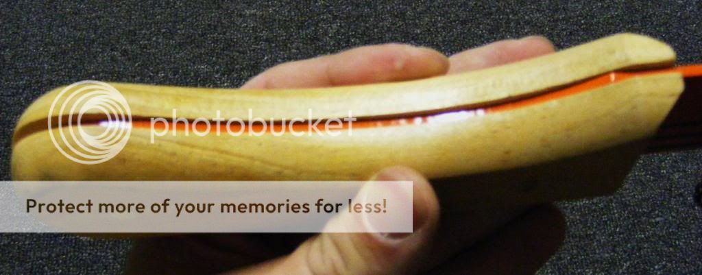

As nice as the handle is, it was far from perfect. Every dimension - the butt, the top, and the back - they all had a lot of wood exposed way past the tang.
Top...
Bottom...
A bit of sanding got rid of this problem (photos posted later on) and it wasn't that uncomfortable, even unmodified. There's no lanyard hole on the Bolo, but the thickness of the handle and somewhat swollen butt (pommel?) does a nice job at preventing slippage when swinging the machete.

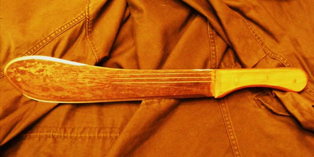

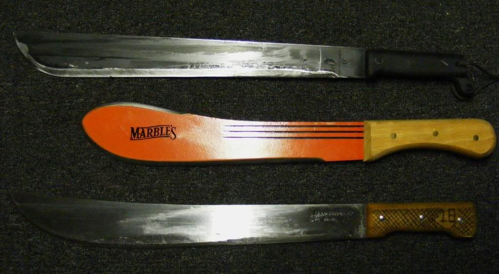

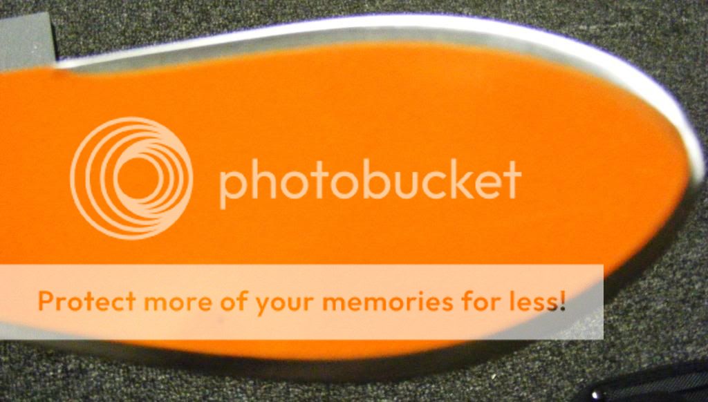

The Blade: The Bolo has a blade made of 1075 carbon steel, which is heavily-painted with a safety orange. The blade is 1/8" thick and 14" long with a 13-1/2" long edge. The tip of the machete is rounded and sharpened, and the "swedge" area on the spine is sharpened to make the edge on the spine 5-1/4" long. All of this is one continuous edge, and came convex ground and nicely polished. It was sharp enough to cleanly slice paper.

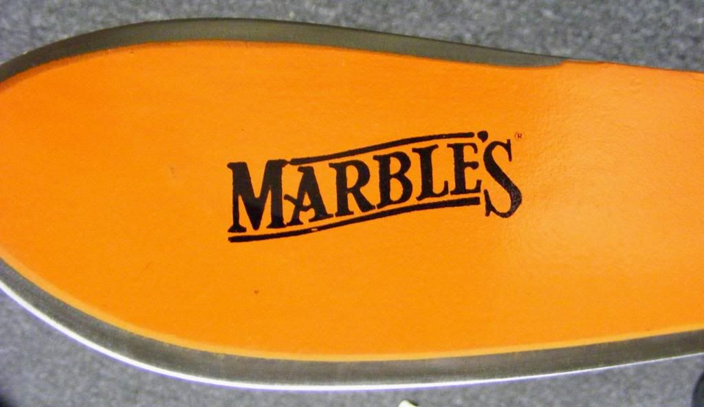

The left side of the blade has the Marble's logo painted on top of the orange. The three lines on the blade are stamped in and are for flexibility...

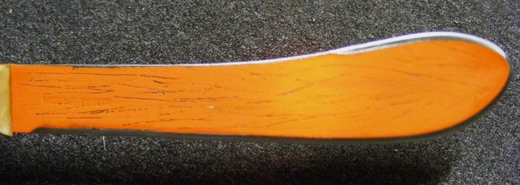

The right side has an easily-removable sticker and MADE IN EL SALVADOR stamped in...
Top...
Bottom...
