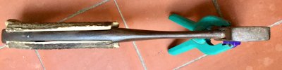

Spotted this rusting away in a friend's garden while they were having a clean out..... 12" overall length...
..... clearly it's in terrible condition, the safety cover is mangled & rusted stuck in the handle & it looks as though someone had a go at sharpening it not too long ago.
I can't see any markings & wonder if the stag scales are a homemade addition?
I think it might make the basis for a project rather than a restoration!
That’s a cool find. The scales are definitely replacement. Rust wise it’s not terrible. The hatchet could definitely be cleaned up. If the swing out is rusted stuck and you can’t get it to budge. Pick up a small bag of swimming pool/spa -PH Down’. Fill 5 gal bucket or 2gal bucket up with hot water and cup of the PH-Down’ stir good. Drop the hatchet in. Close lid. Leave over night. In morning the hatchet will be clean of all rust & crud and that swing guard will be easily function. I have used PH Down to free up rusted metal wrenches that every brand oil rust solvent wouldn’t touch.
Evapo’ likely will not free up a frozen Rusted part like PH. PH is non petroleum. Water & Chem -so easier. Clean up is easy. Just rinse with warm water and dish soap and immediately after I spray Denatured Alcohol to prevent flash rust and let it dry. Only drawback is It completely strips it down to bare metal- patina is gone too similar to Vinegar Bath. I have only used it on a tool that had rusted frozen part. I used it on a Circa 1912’ Stevens crack shot 22 rifle that had a ejector frozen solid. Nothing would free it until I used PH-Down. I used it on a old lantern that was old painted and rusted out. It stripped it clean

Well after a few sprays of WD40 & a bit of time it’s finally given in & come free, it wasn’t as bad as I initially thought , a lot of dirt was removed from the swing guard & spring...
So now the guard is free with a working spring I’m a bit disappointed 😄, because I know it’s become a restoration project now!
I’d almost hoped it was to far gone to save then I’d have an excuse to ditch the guard & fill the gap.
It’s still in a bad state, signs of a previous “restoration” are the stag scales, sanding/grinder marks all over including the guard, & a lead on the guard.
The guard is going to be tricky, as can be seen it’s already been repaired with lead.

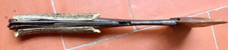

And the only marking so far, probably missed by the sander on the last “restoration”. 🙄
And.......
....the spring broke through rust pitting..
It’s just begging to have the handle taped up & used for throwing.. 😆
so im out of my element here but why not just make a new swing guard??
you have a 90% perfect pattern to build from..
Because it's a complex pressed & folded piece of thin steel sheet that'll have been made in a form.
I'll most likely end up repairing what I've got & (now🙄) making a new spring.

Making a new spring is a good choice. You could use a piece of coil spring from the junkyard or from an old garage door opener. Just heat it to orange and slip it over a piece of pipe held in your vise.
Maybe I should be swatted with a wooden spoon for saying this, but personally I would drill out the pin knock the steel handle out and hang it on a proper hickory handle.
I will say that fixing it seems like a fun challenging experience though, and if you can do a presentable job go for it.
The spring shouldn't be hard neither should the scales, but boy making something presentable of that guard is going to be tough.
Maybe some sheet metal patches can be welded on ?
