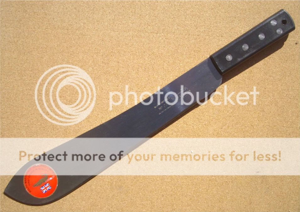

Hi all. I really don't do much reviewing but I had a few people express interest in this particular machete. So I took some pics and made a quick video. Nothing spectacular or overly detailed but just some basics.
Product Description (from Machete Specialists)
A thick, heavy duty cleaving machete designed for vertical chopping.
Brand: Martindale
Total Length: 20 inch
Blade Length: 15 inch
Blade Thickness: 4mm tapered
Weight of Machete: 1 lb 6 oz
Blade Composition: High Carbon Steel
Blade Detail: Some additional sharpening required.
Style: Bolo
Handle: polypropylene riveted
I will start by saying that I really like this machete. It is one of the thicker ones out there but IMO feels like one of my lighter/thinner ones. Out of the box I knew I had to sharpen it so I spent about 1hr with a mil file and got it shaving sharp. Still needs a little more work at the sweet spot but it is good to go now. Full tang. Slabs are larger than tang so I will need to sand them down but that's easy enough.
One surprise was how thin the handles are but that actually is a plus in my book as some of the machetes out there feel too fat as far as the handles are concerned.
I made a quick sheath out of PVC pipe and will attach some molle clips to the sheath to attach it to my pack.
I'll try to add more as I plan on using this a lot tomorrow for some yard work. Here are some pics and a quick video. (My audio is not working at the moment so I added some music and captions).
Video: http://s633.photobucket.com/albums/uu55/HAM-SOLO/?action=view&current=BoloCleaverMachete.mp4
Over all I am very pleased with this machete and plan on really putting it through its paces. :thumbup::thumbup:

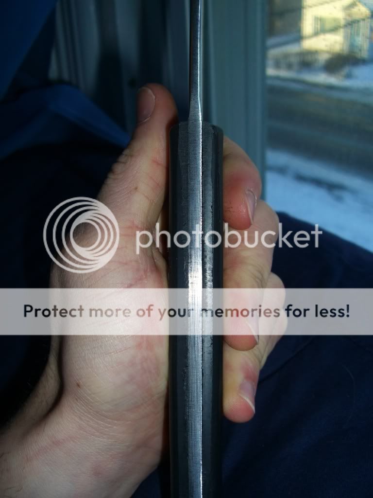

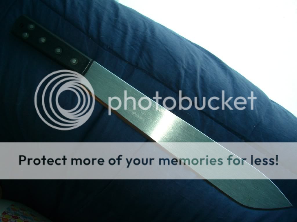

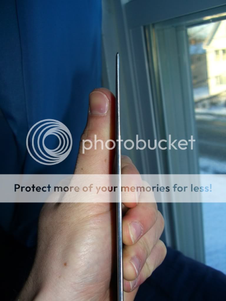

Here are a few pics of one I modified for bushcraft purposes. You can see how strong the distal taper is! :eek::cool:

Great pics FortyTwoBlades. Really cool mods. I remember that one up for sale and just missed it. :( How did it chop with some of the forward mass removed? Did you use a belt grinder to remove the excess metal?

I used a cutoff wheel and some patience (to prevent overheating) to cut away the extra material. I smoothed it all down with the belt sander and used it to put a nice polished convex edge on it. :cool:
It felt great with a little material removed. Not as heavy-hitting, but MUCH more appropriate for drilling and knife-like usage while still having plenty of chopping ability.
I can always make another, you know. :D

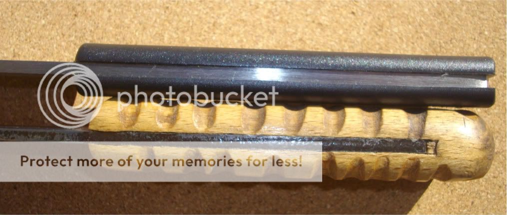

My Martindale Golok arrived. Need to touch up the grind and marry the slabs to the tang, but I like it... More to come!

I just used a dremel for the handles and the supplied mil file that came with the sheath to sharpen both. Then I made a pvc sheath for both as the stock ones are not too sturdy. Lets us know how it works for you. :thumbup::thumbup:

I'll get the handle shaped and sealed proper. I'll adjust the grind on my 2x72". It's going to be a great little chopper.
