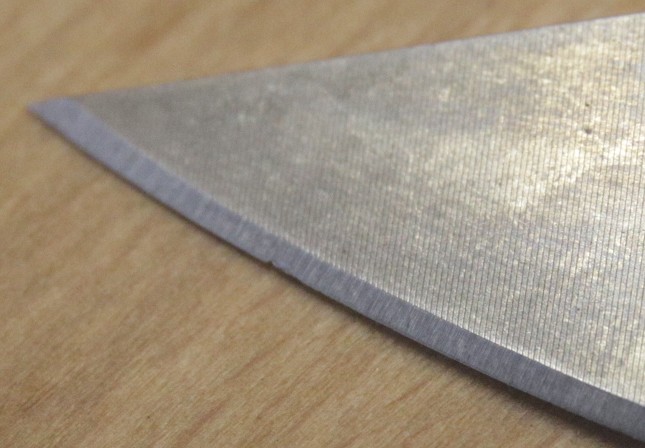

I tried both and IME Maxamet is better, but it is a little bit apples and oranges. I sharpened the GB2 myself and it lasted three weeks (no longer slicing paper). I used the factory edge on the PM2 and it was past three weeks when it was still scraping off hair on my forearm (barely) and was slicing paper (easily). Or maybe I am just not great at sharpening.
But what surprised me was that when I, using wrist action, slammed the blade into the edge of a steel barrel (not deliberately) that was cut in half with an angle grinder, the damage was minimal:
I didn't even bother to fix it, I just kept using the knife and it reduced in size and finally disappeared after the first sharpening, a month later. I think this edge stability is the result of the 67-ish steel hardness and the edge profile.
