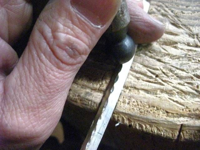

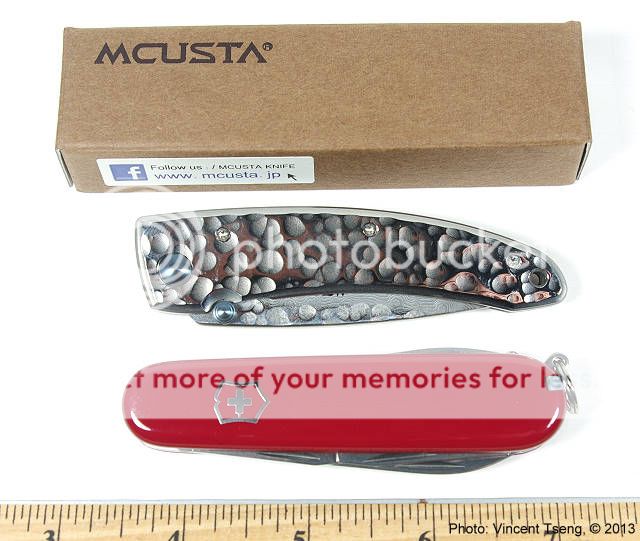

Manually some tsuchime or hammered patterns are done like:

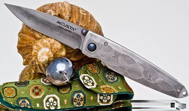

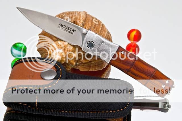

There was another review by evilgreg with some great photos
Look carefully at the handle of his pics -
now examine my top photo - other than different lighting and exposure - the hammered pattern or tsuchi-me are the same......
check any other pic of the Mcusta 113D - Google image search - as long as it's the 113D (and not the larger 114D or black version 114BD) - the tsuchime pattern is the same
so although it may seem that the tsuchi-me are individually hammered - they are obviously not, and are are precisely identically patterned, using some form of template.

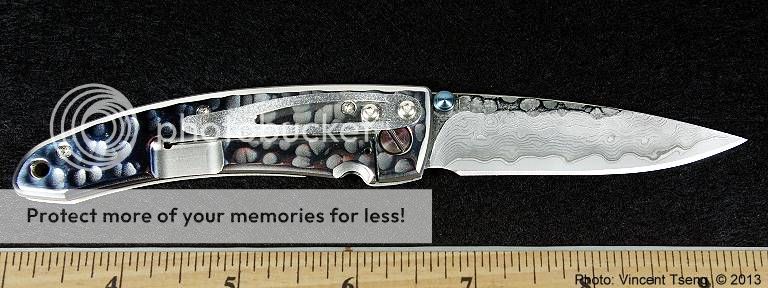

The tsuchi-me pattern is also on the blade flat/face of the 113D -

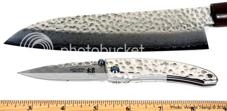

Some more on tsuchime - I first noticed this on kitchen knives (the Shun Premier series may perhaps been one of the first popular brand using tsuchime pattern)
Mcusta 113D with the blade of a SETO I-5 santoku with tsuchime pattern.
with SETO I-8 135mm mini santoku.

The "damscus" pattern (which are different for each blade) is particularly pleasing as in the second pic above
The "damacus" cladding is nickel (Ni) and steel and then probably etched so that the nickel pattern lines are raised.

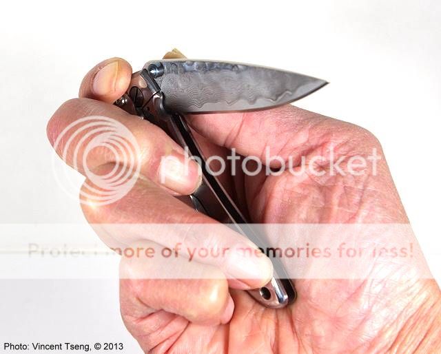

The action is very smooth - a bit on the stiffer side - the smaller size and the way the thumb-stud is recessed when closed means one has to get used to the configuration to open the blade well -
but once that's done it is easy and very smooth.
