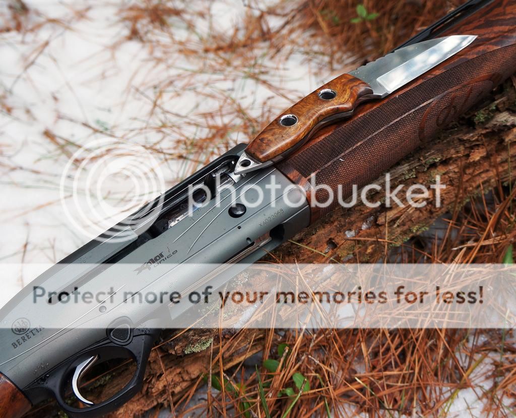

I Finally got a minute to get around to creating a thread that will show the progress of the current MDB run. This is my first WIP so bear with me. The MDB (Modern Day Box-cutter) is a model I have been working on for about a year and a half. I wanted a modern, lightweight, sleek and functional knife that was inspired by the box-cutter utility knife and a small seax, two very popular utility knifes. I wanted this design to complete everyday cutting tasks as well as pull protection duty. I utilized the straight edge configuration and thin ergonomic handle, and based my design around these principles. When designing the knife I thought a glass breaker/skull crusher would be a great feature for the ultimate utility/defense blade. This knife is made of CPM 154 Stainless Steel with a thickness of 1/8''. I believe it makes the perfect knife for simple tasks such as opening up boxes and cutting rope, but is still durable enough to defend yourself. I believe this knife is an evolution to the most used blade in the world. This knife can be held in a reverse grip or regular grip and be a real nasty slasher. You can also use the back of the knife as a non-lethal option. And lastly you can punch with this knife in either hand and the unlucky victim will think they got hit with a fistful of Nickels. My process for the knife model is not well established yet so I am still trying things out. The blades are coming along nice and I cannot wait to see the finished batch! There is a lot of variation in materials and it is always cool to see how different the same knife model can look! Stay tuned for updates on this forum as well as on our Facebook page and Instagram. Thanks for looking.
Here is the last prototype;
