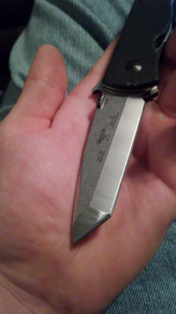

Howdy!
I finally bought myself an Emerson!
A CQC-7BW.
Bought it "moderately" used while on vacation.
It's got some scratches on the clip, a chip or two on the scales, and a chip near the beginning of the Tanto.
Well centered with no play at all.
I've never owned a chisel-grind before, or an Emerson.
Got home, figured I'd try to fix the chip.
I figured I could handle it.
Well..... When I went to sharpen it, I went to use the same angle I normally use on all my other knives. (I freehand).
Lo and behold, I was WAY too acute, and scratched the HELL out of the Tanto.
The grind lines aren't exactly perfect either.
So...my question.
Would you:
A-Not care whatsoever
B-Not care and use it "differently" (Harder use, maybe as a beater)
C-Send it to Ernie and pay for a new blade
D-Use some sort of magic to fix the scratches
I would take scotch bright and pull it over the problem toward the edge until it blends. Then try to work the edge again. If this doesn"t give you the results you want....send it in....or beat on it. I would not work the primary grind on a stone, might cause more problems than you want, judging from your sharpening attempt. At least you gave it the old school try, as far as sharpening (its all cosmetic in the end)! Just keep working at it...live and learn, you will get better
Did you buy the knife to use, or to look at? If you bought it to look at better send it in and get it fixed. If you bought it to use, then use it. There is nothing there that will keep it from cutting just fine. Years from now that will just be one of many small marks that make it not just a knife, but "Your Knife".

Thanks for the kind words.
I'm obviously not fantastic at sharpening, but it's not very often that I screw up a knife. Only other one I messed up was my beater Adamas, and I DEFINITELY wasnt being careful with that one. :D
I'm thinking about that scotch brite idea.

Bought to use
Well, it sounds like cosmetic damage annoys you like it does me. I don't mind normal wear and tear so much, but damage like that drives me nuts.
The scratches are no big deal. but the edge/bevel looks like it is all over the place. You might contact one of the professional sharpeners on the forum. I doubt you have to go with a new blade.
If it bothers you, get a re grind on the blade. There's a few guys here that do great work. The knife is worth a regrind. But its just cosmetic so you could use it and let time and wear sort things out for you.
Also try sharpening the blade at around 25-28 degrees. I sometimes go 30
Cheaper than a new blade would be to send it to Josh at REK to reset the secondary bevel to a nice, crisp line. He can probably buff out the scratches at the same time. Send him a pic and get his advice on it.
