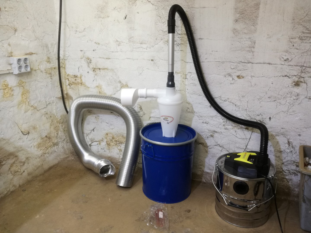

I just ordered one of these. It works with a normal vacuum cleaner. It is claimed that 99% gets seperated.
Still waiting for it to be dilivered, so no actual experience with it.
watch
I got the setup including the metal drum in Germany but you can get the top part that does the job on Aliexpress or Ebay. (Some people make theire own)
Search for "zyklon scheider" on Aliexpress, click on one and switch back to English.
The vacuum goes in the top, the dirty air goes in the side and the dirt goes down in the drum.
the drum needs to be airtight and strong, plastic is usually not strong enough.
Thnx for the tip I'll put water in the drum.
Thanks
Got all the parts together today. Now all I need is my new grinder and I'll be able to tell you how it works :)
I ordered the "dust commander" fixed on the metal drum. Big advantage is that they also sell adapters in all thinkable sizes.
I'll place the vacuum in a different room to keep the noice down. May even build sound isolation around it.
This is where I got everything.
zwiezyklon.de
The inlets are 50mm.
I'll be using 100mm tube to suck the dirty air off. The vacuum I have has a 32mm inlet.
Got the adapters with the dust-commander/metal bin.
Only thing is the 100mm tube fits on to the adapter, not in or over it, so there will be a bit of duct-tape after all :)
