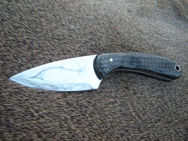

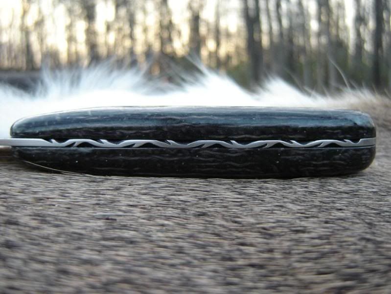

Black burlap I made
Standard burlap I made

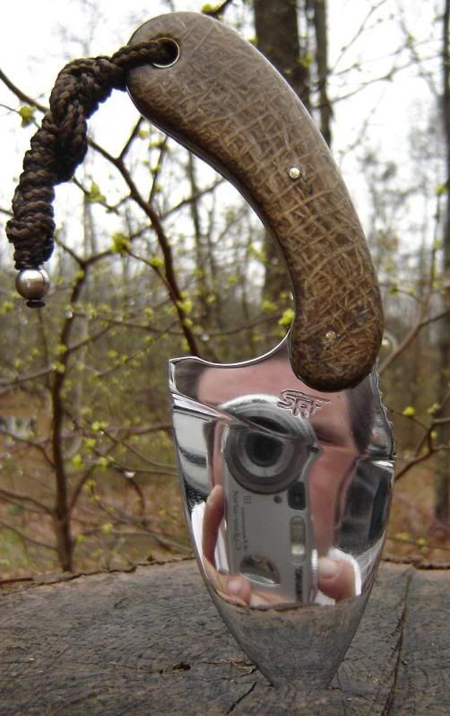

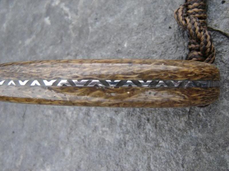

The top knife was featured in Tactical Knives and is Joel Bolden's own Denim Micarta...
"JoelCarta" if you will ;)
In hand it feels like the paper micarta in the knife below.
Definitely something out of the ordinary.
I don't know if denim or burlap micarta is for everyone, but I sure like it on this knife.
