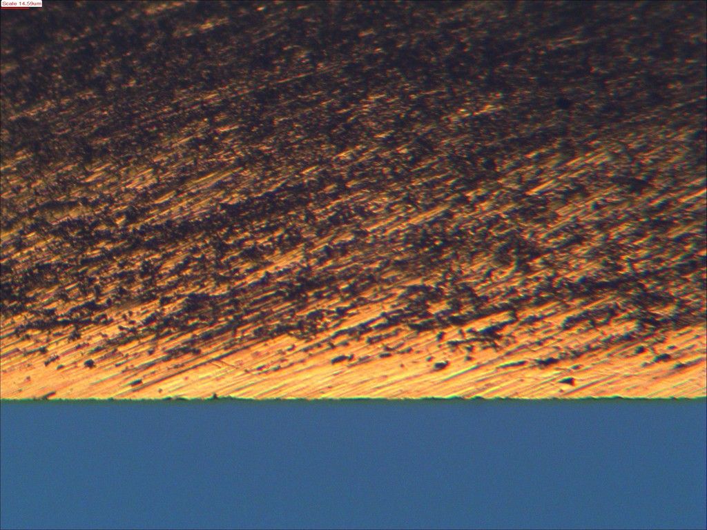

This is how I still look at it. I most often use them as a shortcut from a coarse or medium to a finer hone or surface. Often on these jumps one can still see much of the pre-existing grind pattern but it's been worked thin...at a more broad angle - if that makes sense. The mean width across the edge is less but joins at a wider angle. In this way the edge gets a lot "sharper" and there is no functional loss of acuteness, the opposite actually.
Here's an old pic of one done IIRC on a Ik Norton waterstone and partially micro'd on an 8k mostly edge trailing. You can see the frosted surface from the lapping action of the 1k, virtually burr free grinding. The 8k overlay makes this a real fast one-two treatment and allows a bit of customizing - more passes = better pushcutting/fewer passes = better draw.
I use a similar approach on DMT's going from coarse or maybe a fine to the EEF. I normally do not microbevel unless it is with a much finer honing surface - the only consistent exception is when restricted to working with very coarse abrasives.
