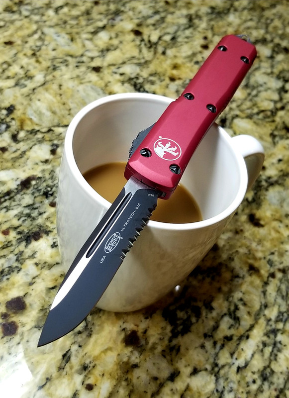

I have a microtech ultratech, bayonet style blade in elmax steel with a build date of 7/2015. It has the old style tri grip texture instead of the smooth body found today.
This knife is on a small table by the front door and it is my companion every time I go check the mail. I use it to open letters, cut open packages etc and will open and close the OTF blade approx 7 times while walking back to the house with the mail. So I figure 7 open/close x 5 days a week x 52 weeks a year x 4.5 years of ownership for approx 8,000 firings. It is now on a rare occasion starting to misfire. Sometime on the deploy, sometimes on the retraction the blade doesn’t fire to completion. All I have to do is whip the knife point downward and the blade will lock into the open position. Then I simply retract the blade with the trigger and all is well.
I would guess once every 50 firings it might fail. I will look into sending it back to the mothership for sharpening and repair/replace of worn parts. Overall I have been happy with the build quality and performance. Hope the turnaround is not too long. The Microtech home page does list possible delays due reduced COVID staffing.
Sharpen it yourself, spray it out with some WD40, and fire it 8,000 more times :cool:
Negatory on the wd40. It might work but when it starts to get gummy, it’ll lock up.
turn it open slot up. Fill it with naphtha. Zippo lighter fluid. Or Robson brand, don’t matter. Let it sit awhile. Turn over and drain. If yucky, repeat. Once done, turn slot down and fire a few times. Get the excess out. A drop of thin oil, like rem oil, on the choil and THEN fire it another 8000 times. Should clean that occasional misfire right up.
