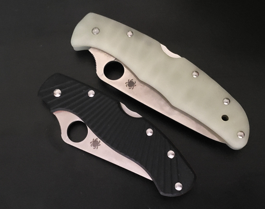

I finally got around to plopping Military'esque profiles onto the Endela and Delica frames as I previously did with my Delica/Lil'Para MOD.
There are a few compromises that were necessary to accommodate certain unalterable areas in both the Endela and the Delica knives. The resulting profiles are more an homage than fidelity.
My initial efforts to retain the profile as close to the Military's as possible resulted in exposed blade notches on both knives . I do not believe this would be acceptable so I massaged and enlarged the choil bulges to encompass and bury the notches.

Spent the morning running the Endela/Military and the Delica/Militia profiles through CAD for the 3D modeling... then CAM for the needed machining operations. I now have files that require proof machining to determine the precision and accuracy of my models. That will happen shortly...

OK... the first set of PROMOD (profile modified) Endela/Military scales were the result of a request from a Forum member father to gift to his active duty military son. The scales machined flawlessly and no adjustment tweaks were required. The code is now locked down. These are NOT full contour as a peel ply texture was desired.
These are configured for tip up carry...
So today I was able to machine the FIRST set of 3D full contour PROMOD Endela/Military scales. Black G10 with blue G10 liners... diamond checker texture. The machining went flawlessly and I'm now awaiting for the Endela I ordered to hit my cluster box to be able to assemble and take some photos...
The CAD render said they would look like this...
Here's a quick shot of them fresh off the machine...
