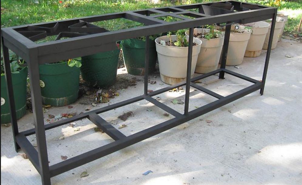

So I have gotten to the point stick welding with my Miller Thunderbolt AC/DC welder that I don't have to grind off every weld :D
I've gotten the MIG bug as a friend who is into brewing asked me to make him a 3 pot brewing table. No problem just some 1.5" 14 guage square tubing basically.
The Miller
http://store.cyberweld.com/mi211migwewi.html
The Hobart
http://www.farmandfleet.com/products/678611-hobart-handler-210mvp-mig-welder.html#qa
So there is a couple hundred dollar difference in the two which is enough to pay for a 80cf tank if I go with the Hobart. Since the feed speed determines amperage anyway is there that big of a difference with the tapped voltage on the Hobart vs. the infinite on the Miller?
He might have a couple other brewing buddies that might want one as well so if I made a couple hundred from each of those that is part of the consideration as well.
Any thoughts would be appreciated!
