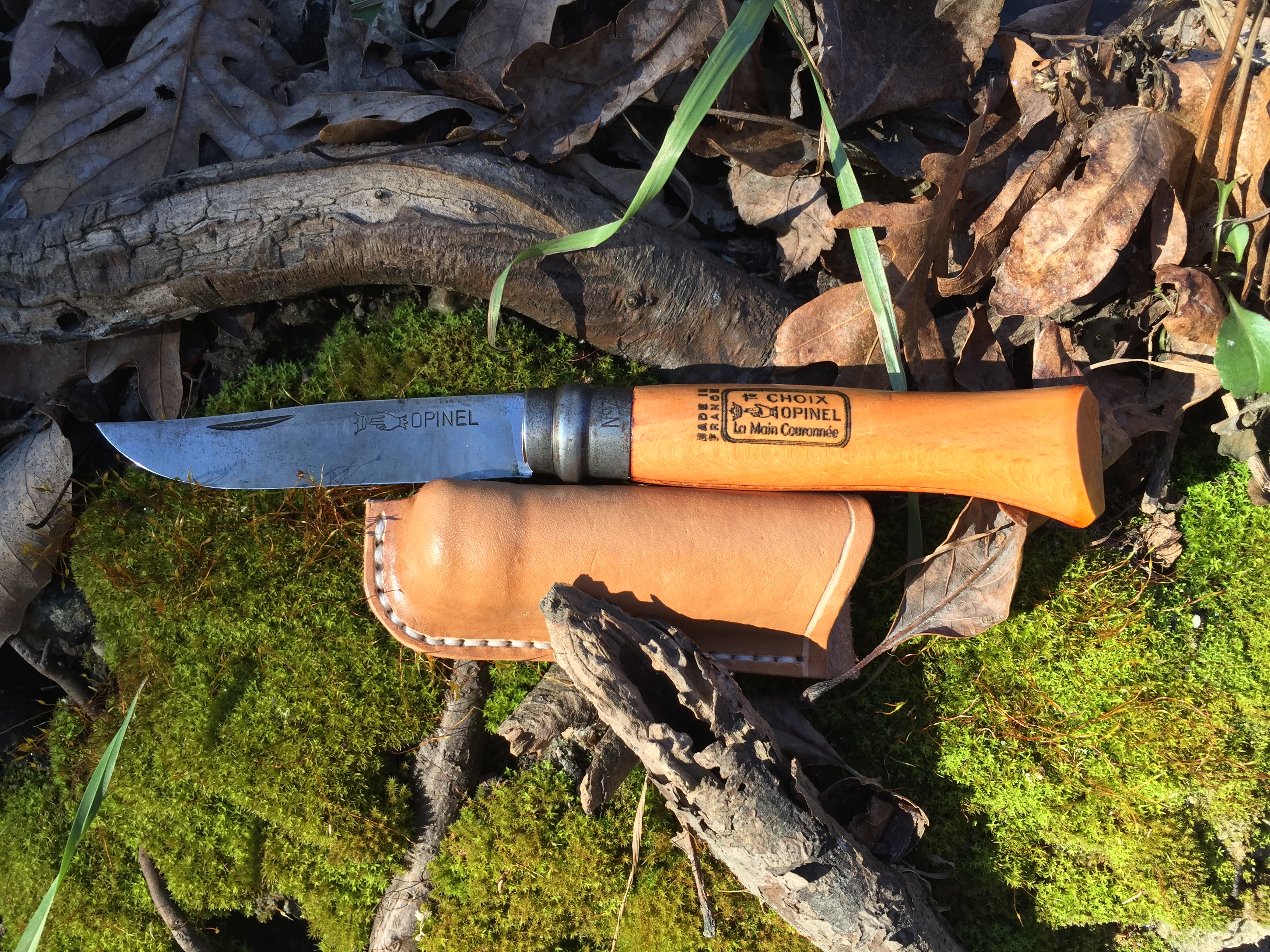

For what it is worth, the edge that you generally end up with on most Opinels is really fine. Often you cannot see it clearly. If my edge is really dull, I will use a fine DMT hone to get it back in shape. Then I move through a progression of Arkansas stones (soft, hard, hard black). That hard black Arkansas polishes that very fine edge bevel quite nicely but that bevel is so small, I cannot really judge the "mirror" quality of it. However, I find that it makes for a very nice edge that does not require a lot fussing over.
Above you can see what I mean on my No. 7. I find that the Arkansas stones work great on both Carbon Steel and Inox blades.
