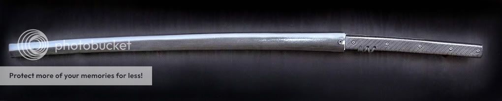

Here she is...
S-7 steel RC 58, 41 3/8" oal... carbon fiber twill handle with G-10 spacer, 0.262" thick, 3lb 0.5 oz, seamless carbon fiber skin over laminated bamboo scabbard...zombies beware!

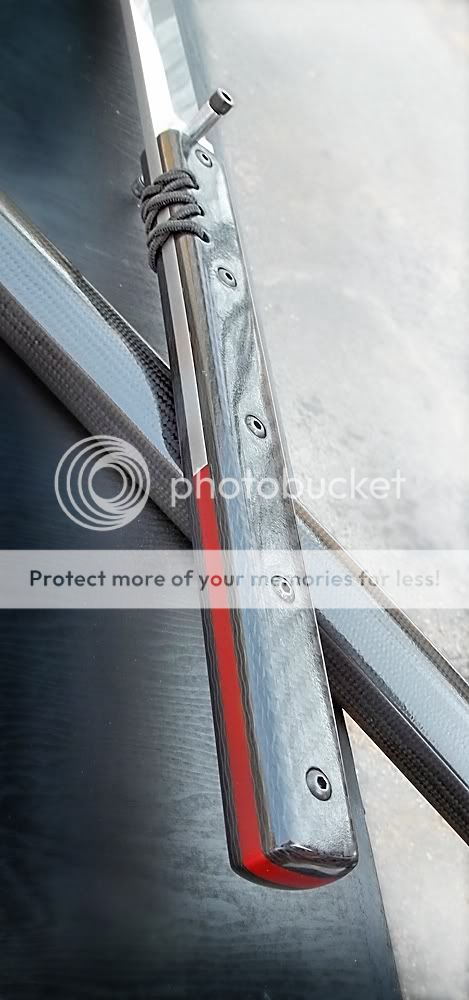

Only because I needed it for the CKG show! How do you like the red G10 spacer?

What's the bolt through the blade for? guard? lock for the sheath?
That assembly through the ricasso is a guard (removable or can be added to) and indexes the sword in the scabbard, the hole is less than .25 in diameter and it's in the thickest, widest part of the blade... more likely to fail in the beveled part of the blade because there is way less steel there, plus the blade is S-7 so I think we're good on durability.
Traditional katana were very weak in this area owing to reduced width, though maybe this improved harmonics especially with a soft habaki... very hard to test scientifically but you don't see many traditional katana being wailed on like mine are!

That Kat is so nice. What is the blade length?

It looks nice, William, but that lack of "proper" guard/tsuba is problematic....even whaling on a blade like this, there is possibility for the hand to come in contact with target material, and a proper tsuba really helps in that case.

Interesting... I was pondering while designing this just how close to the hand you might start a cut. It would be nice to see some high frame-rate video.
I think the red throws off the design a bit. A neutral gray to match the carbon fiber pattern would look better, I think.
I like the cordage looped through the handle. Cord as jimping!
I don't like the crossguard. I would opt to remove it if it was my blade.

Does the tang extend into the G10 spacer, or does it just stop there?
tang stops where g10 starts, saves some weight
