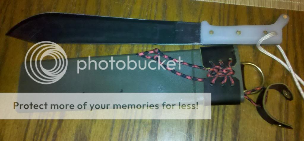

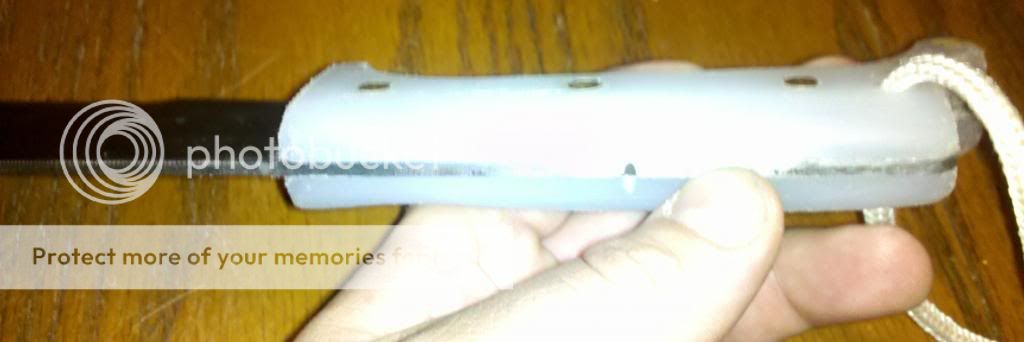

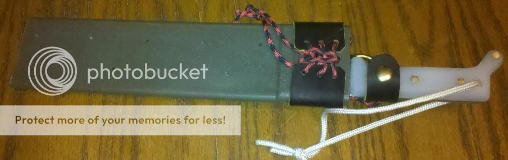

I wanted to share my budged BIG knife and ask any opinions or comments. I took a 12" Ontario military machete and got rid of the handle with the compression rivits that always seemed to fall out. The handle is polypropalene with brass pins coned on each side and the scales glued on. I made the hanger for the sheath and use a carbiner to hang it on my belt. This thing can take a beating and is often used to baton logs up to start the fires in my wood stove. So far I've done this with both 18" and 12" Ontario Machetes and been quite happy with the performance. Though, I like the 12" better. I actually kept this instead of my BK7. I know....bordering on blasphemy there.

If only they actually just made it like that from the factory. The present handle scales totally defeat the point of injection molding--the idea is to NOT have to shape the scales after they come out of the mold. :D

How did you achieve the clip point? Im looking at my 18in Ontario right now and she needs some mods lol. The most heavy duty metal removing tool i have is a bastard file.....
I just marked it with a pencil and hit the grinding wheel. If you do that, you have to dip it in the water often to cool it. You don't want it heating up and discoloring or it may mess up the temper. Basically, one or two light passes then dip. After that I hit it light on the sharp edges from the grind, used a file to round it, then sand paper to make it all smoothed out. It works pretty good and doesn't take that long. If you plan on doing much metal anything, I'd drop a few bucks on a decent grinding wheel. You can do it with a file but it would take WAY too long with the 1095 hardened steel to do this.
