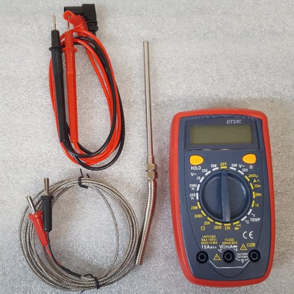

I have simple, cheap units available on my web store for a fraction of the cost of the Auberins units. I put these together because most makers don't need the accuracy of the more expensive units and this units reads in °F up to 1999°. For that matter, most makers rarely use them when heat treating once they've learned the color/temp correlation. Once you learn what color is 1475°F, that's all you need. When that time comes, you still have a decent multimeter.
http://www.atlasknife.com/product/100mm-thermocouple-set/
To use the thermocouple, I recommend placing the probe under the metal
as it sits in the forge. This will give the most accurate reading.
