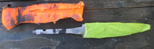

511 tang:
Companion HD tang:
Keep in mind they have changed tang styles over the years, presumably for ease in automated manufacturing. I don't care for the big notches in some of the more recent knives, as it adds stress points. No problem if you're not batoning.
For the record, you'd be correct that the notches in a tang adds points of higher stress, but we're not talking about a free-standing steel piece.
The tang is supported by the injection molded handle.
If a Mora was to fail during batoning, I would be surprised to see it fail inside the integrated handle.

511 tang:
Companion HD tang:
I think the notches are to adjust the balance of the knife and add some mechanical "grip" to ensure the handle can't slip off. I also question whether you'd be able to tell if the the end of the tang cracked inside the molded handle, rather than closer to the blade.
100% they're there for tang-handle connection. I doubt Mora is fine-tuning the center of gravity of the knife by fractions of an ounce, particularly when blade length plays such a large role in that.
per my earlier post, I don't think a mora would ever break inside the handle. The steel tang is supported by the plastic.
The design of the 511 tang looks more convoluted than necessary for just mechanical connection purposes, but it's speculation either way.
I agree that the failure would most likely be on the unsupported part of the blade. My point was that, even if you did manage to break the tang inside the handle, how would you know?
Just figured I'd follow up- I wrote this email to the folks over at Mora:
Hello,
First, a sincere thank you for your great product- I wish you the greatest continued success.
Second, a question has come up on a knife forum, for which there was much speculation, but I was hoping you could answer definitively.
What is the purpose of the notches in the tang of the injection molded knives, such as the 511 basic or the Companion?
Thank you for your time,
Mora took the time to respond, which I think is pretty great for a company pumping out sub 100 dollar knives:
Hi Daniel,
The notches on the tang are intended for indexing (position) and fixation in different tools and blade carriers in the production. They also help to fix the blade in the handle after moulding.
