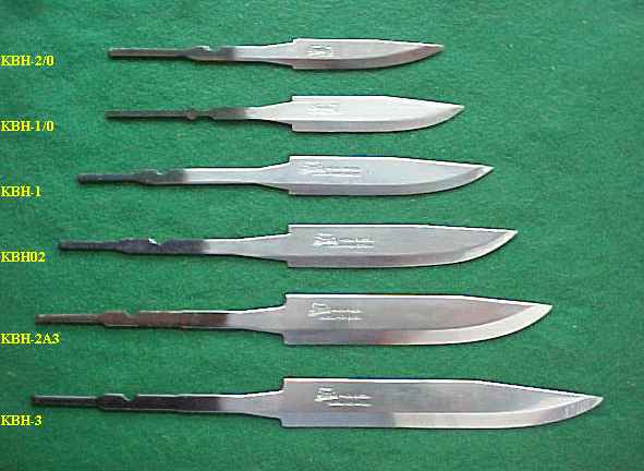

At this point I will probably buy a pair of the KBH-1 blades - a 4" non-laminated blade made by Frost in Mora ($6.50). I'll then make a wood handle for one, and if I buy the second, pick up some antler from the PaleoPlanet folks for that. Please though, if you have a better idea or more info on Laminated vs. Carbon vs. SS, please tell me.
~CanDo
That is a great Idea. In fact I did the same thing, except I made the antler handle first, and today I'm hoping to get started on a wood handle. And, I'm using that exact same blade. I think you owe it to yourself to try and re-handle your own knife, it is so satisfying to see the end result. Just remember to have patience.
