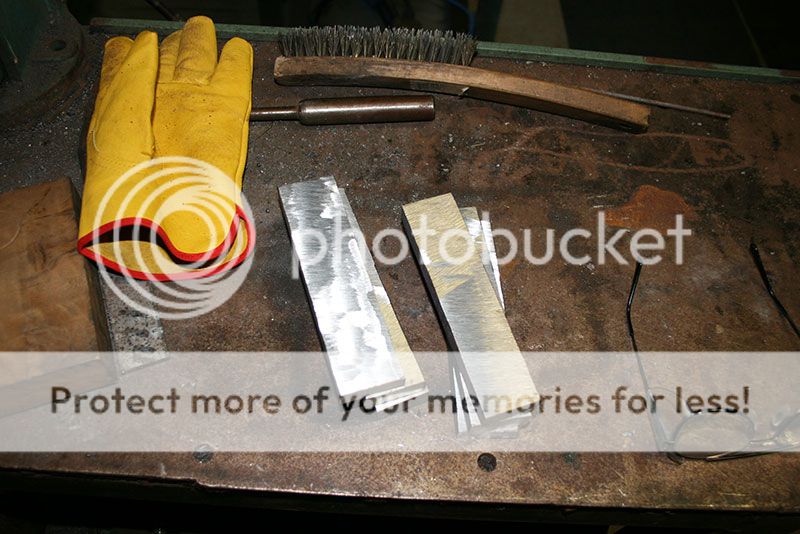

Start of with some 1075 and 15N20. 3 billets 0f 21 layers.
A bit of cleaning up and tack em together.

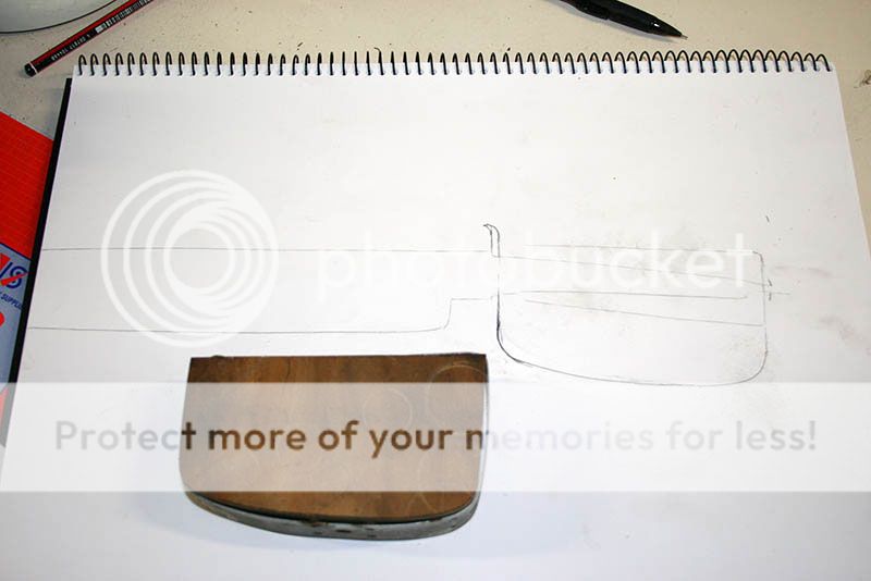

Here is the plan.
Ya with me so far?

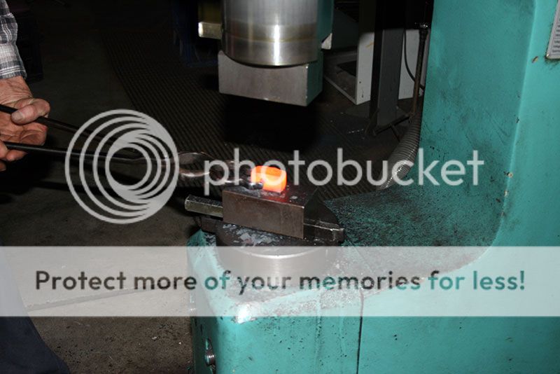

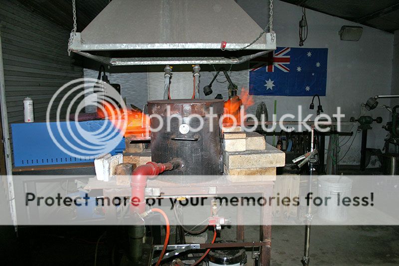

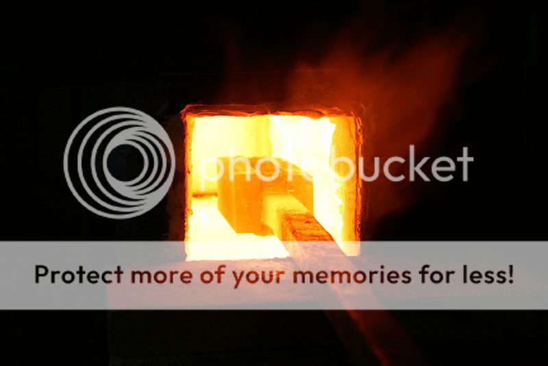

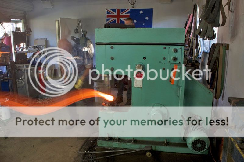

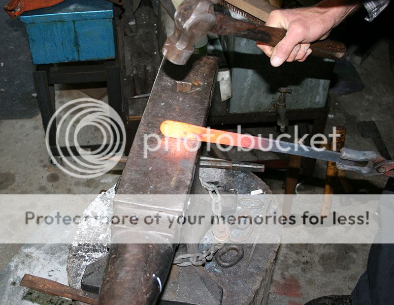

So now I have the billets welded, time to manipulate under the hammer.
Draw out and restack and continue.
A little more as it progresses

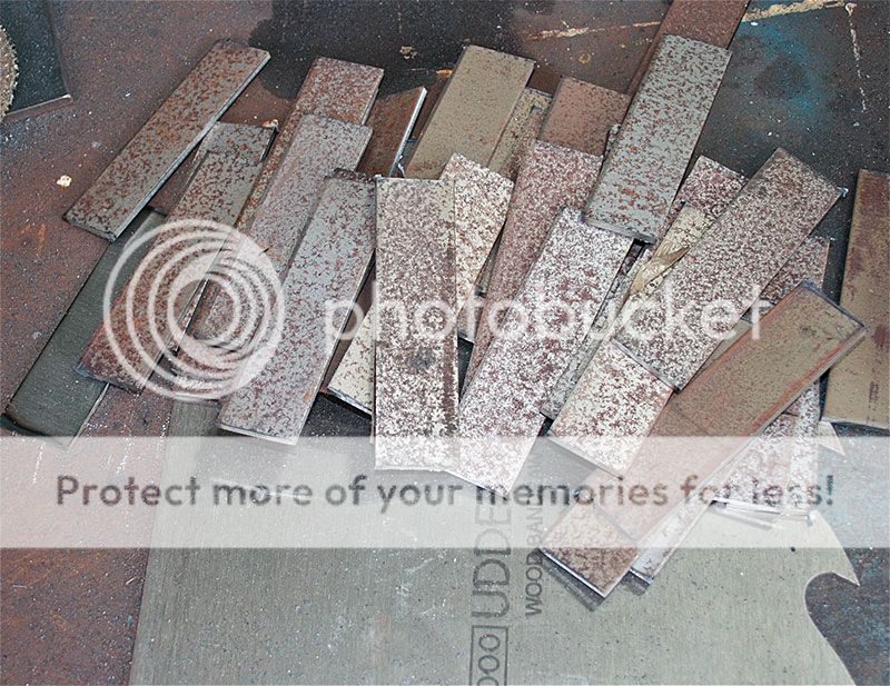

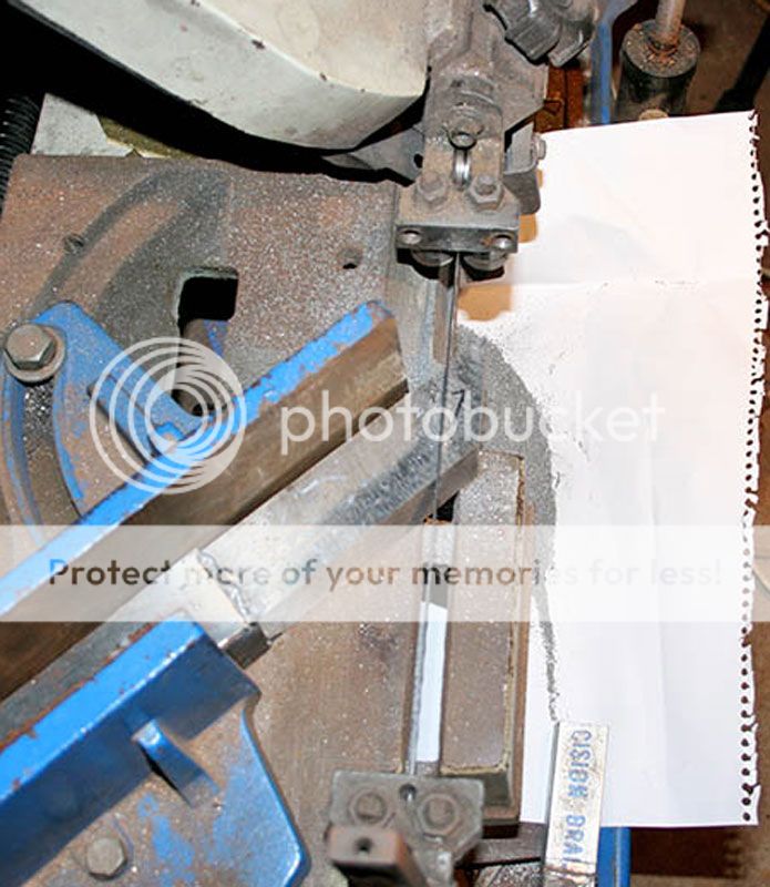

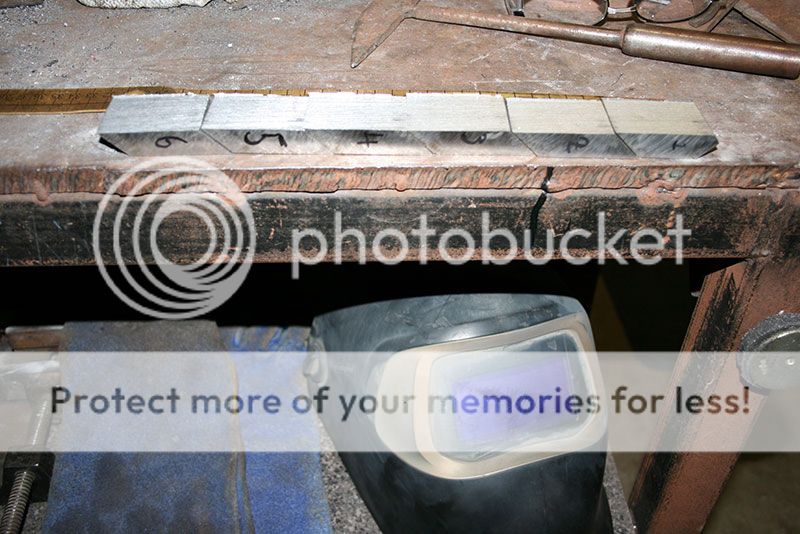

So after a bit of cutting and restacking, I forged the billet on the bias and resquared and drew it out and made a 6 way and rewelded. Squared up tacked the billet onto some bar stock so I could cut the tiles.
laid the tiles out and mig welded the seams. At this stage I made 2 billets of tiles and then rewelded them back together to give me one real long piece. I can get a good weld heat in the forge at about 10" long. The inside diameter of my welding forge is 14"

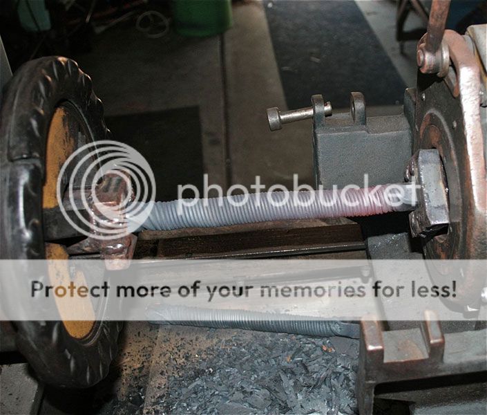

Once welded, put them in the twisty maker. 1 clockwise, 1 anticlockwise.
Resquared and reduced by 50% to reveal the axis of the twist. welded back to back ,draw out into a square bar.

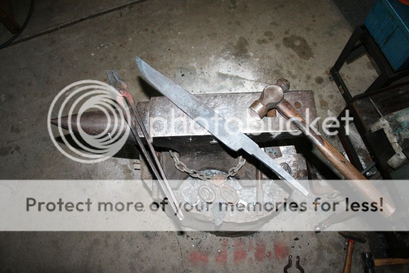

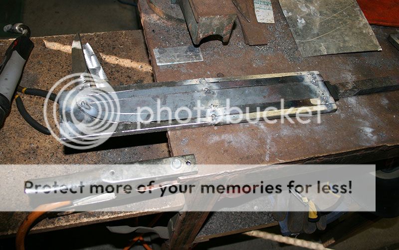

After a bit of cleaning up I set up the inner core and forge to shape the outer bars. I did this with the oxy, a little better contol on the heats and I only have 1 pair of hands.
When I have it all to shape with a nice tight fit, I made a frame out of some bits and pieces. Its hard to see in the photo but I cut some strips of stainless foil so the blade doesn't stick to the frame during the welding process. Tack weld it. Then into the forge for a weld. This is another first for me ( using a frame that is ) Weld took and I'm very happy with the result. Bit of grinding to get the frame off and clean up the tack welds, forge out the shape.

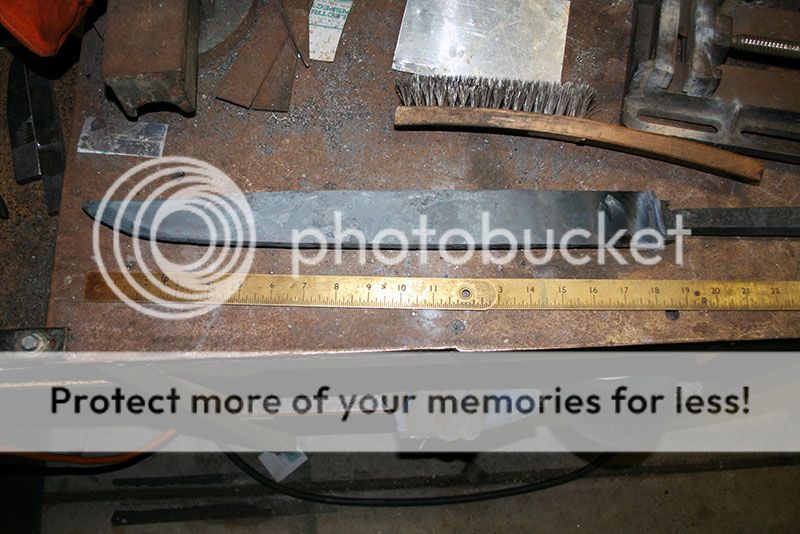

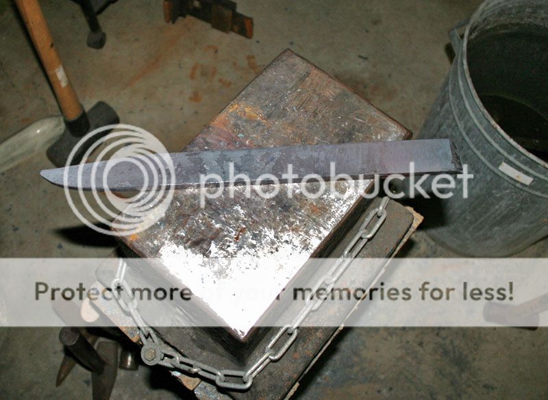

Quick phone call to my client to check what length the blade should be. 14 Inches, yikes :eek:. And forge out the ricasso and tang.

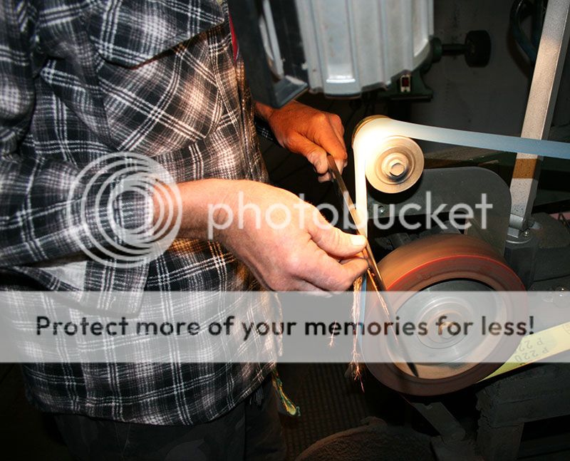

So A bit of cleaning up to do. I'm going to be doing a bit of cattle carting on this one as I don't want to forge the bevels in and disrupt the pattern. Flat ground with a convex edge a tad over 1/4 high. Here I am grinding the convex on the slack belt after heat treat therapy.

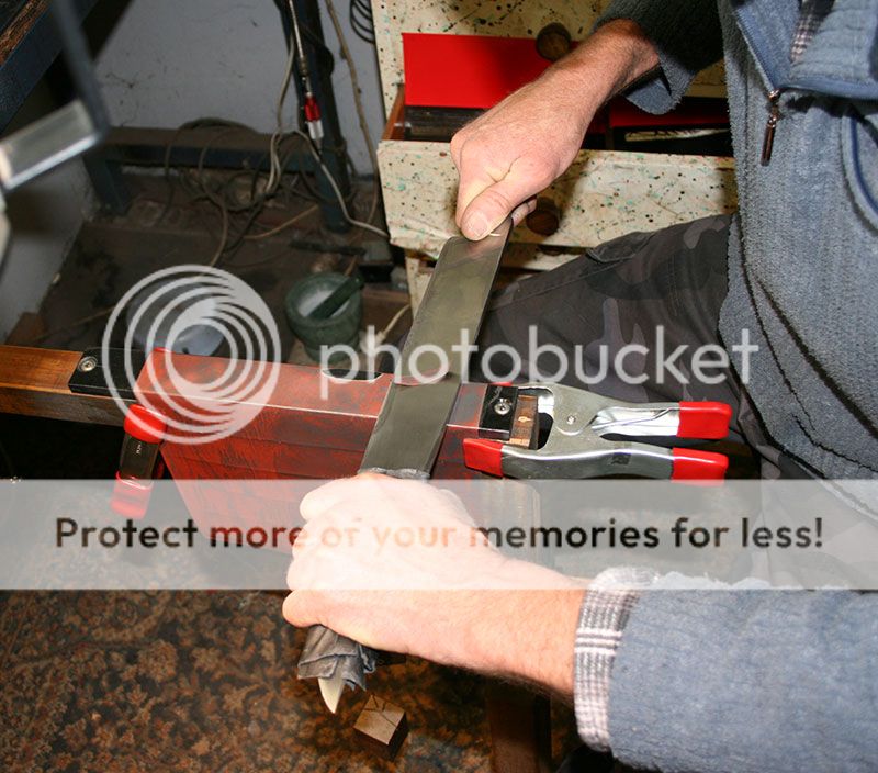

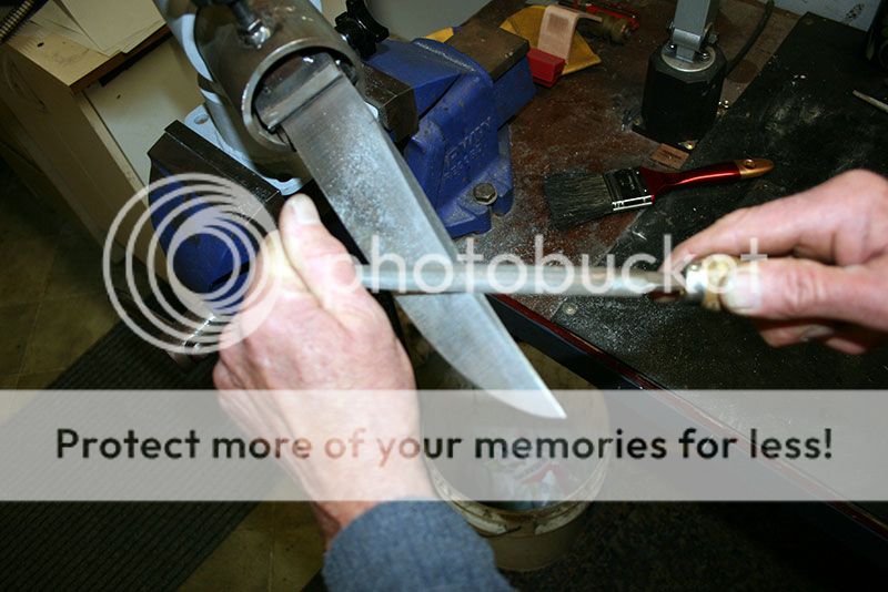

Time to do some hand rubbing, YAY. Because of the convex edge I use a rocking motion on the blade, must remember Keith,must remember, must remember....... pull don't push!

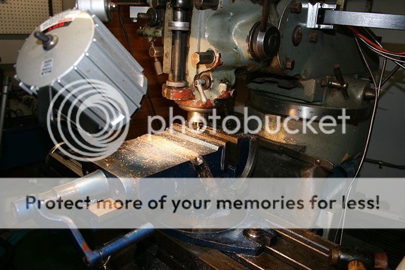

Then cut the slot on the mill.

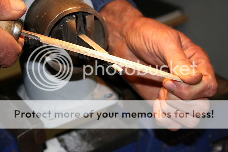

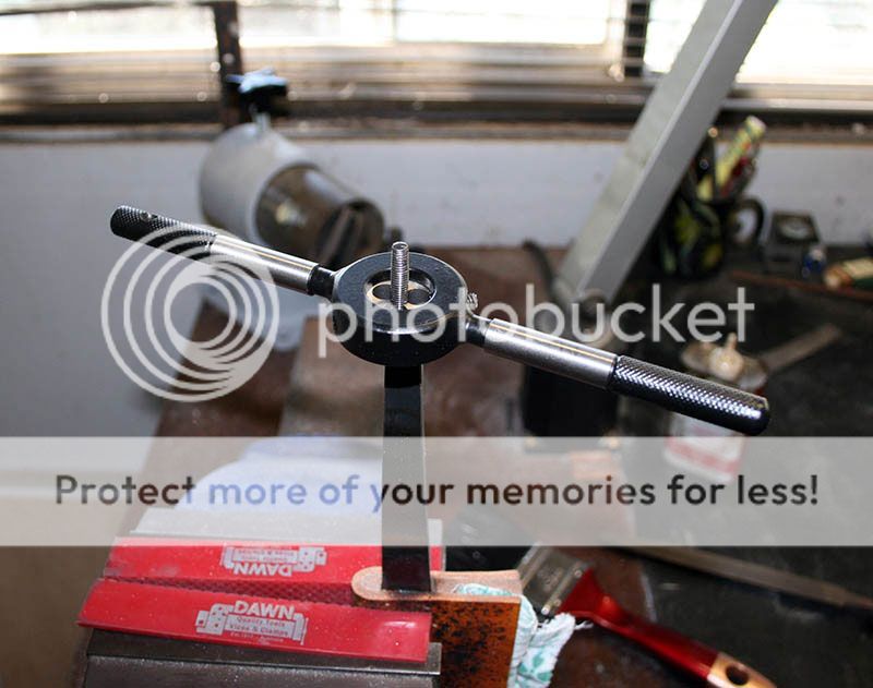

Need to cut a thread on the tang. I grind a round section then finish file to the appropriate size for the button die

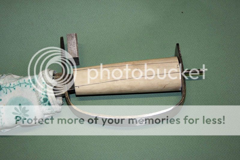

Okay now its time to make the guard. Forge out the piece with a taper.

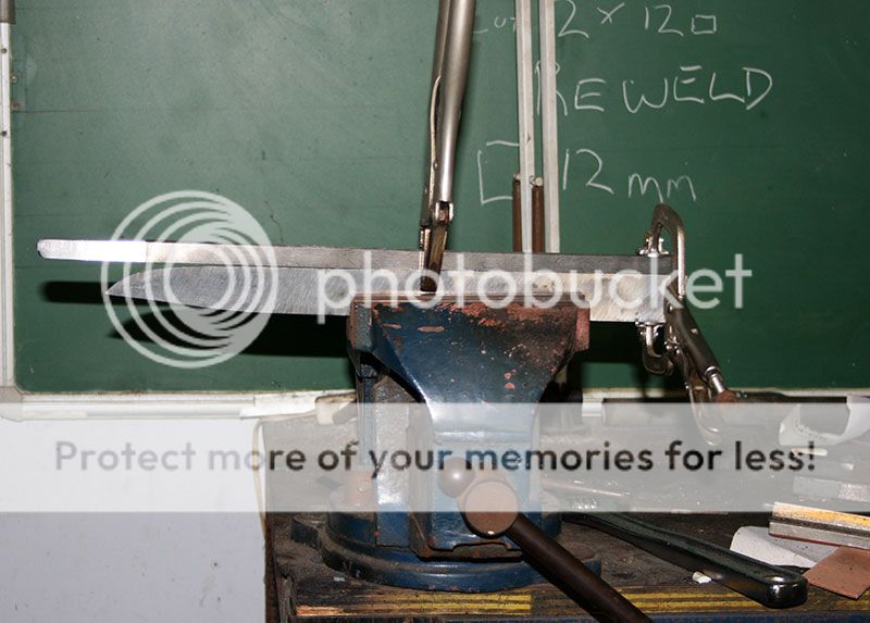

Now I have to admit I made 3 guards. The first one I made out of scrap steel as an experiment so I'd work out the length I needed etc. Well I did it on the horn of the anvil,,,,,,,,,,,, um well, made a bloody mess of that, but I did get an idea of how much steel was required. Plan B I forged out the taper( larger at the butt and smaller at the ricasso) and bent it with the aid of the oxy in the vise. Well hit my dimension marks real well but the bends were 90 degrees pretty much. It looked hideous imo. Well beat it out and up a bit until I turned it into um,,,,,,,,,,"something" that I could probably enter into an art gallery and call it untilted.
Plan c I made a pattern out of some hardwood and wrapped some steel strapping around it and used it as a form to bend the guard material around with the aid of the oxy.
Here it is with the spacer and Walrus tusk handle ready for some final tweaking.
