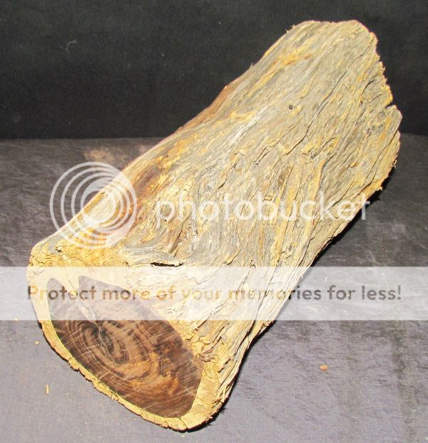

Rosewoods, Blackwood being one of the really good ones. I managed to score a couple of pieces of gorgeous Belize sourced Honduran Rosewood burl a while back and it was great stuff!!!! The wood guy at the back of the ABs section at BLade this year had some, but he was sure proud of it if you go by pricing!!!! Most of the lignum vitae out there for sale today is probably the "Argentine Lignum Vitae" which is not the real stuff.

MUCH easier than some others. Ironwood, Argentine lignum vitae and some others are downright gummy. Blackwood and the other rosewoods are much more forgiving than some woods.
