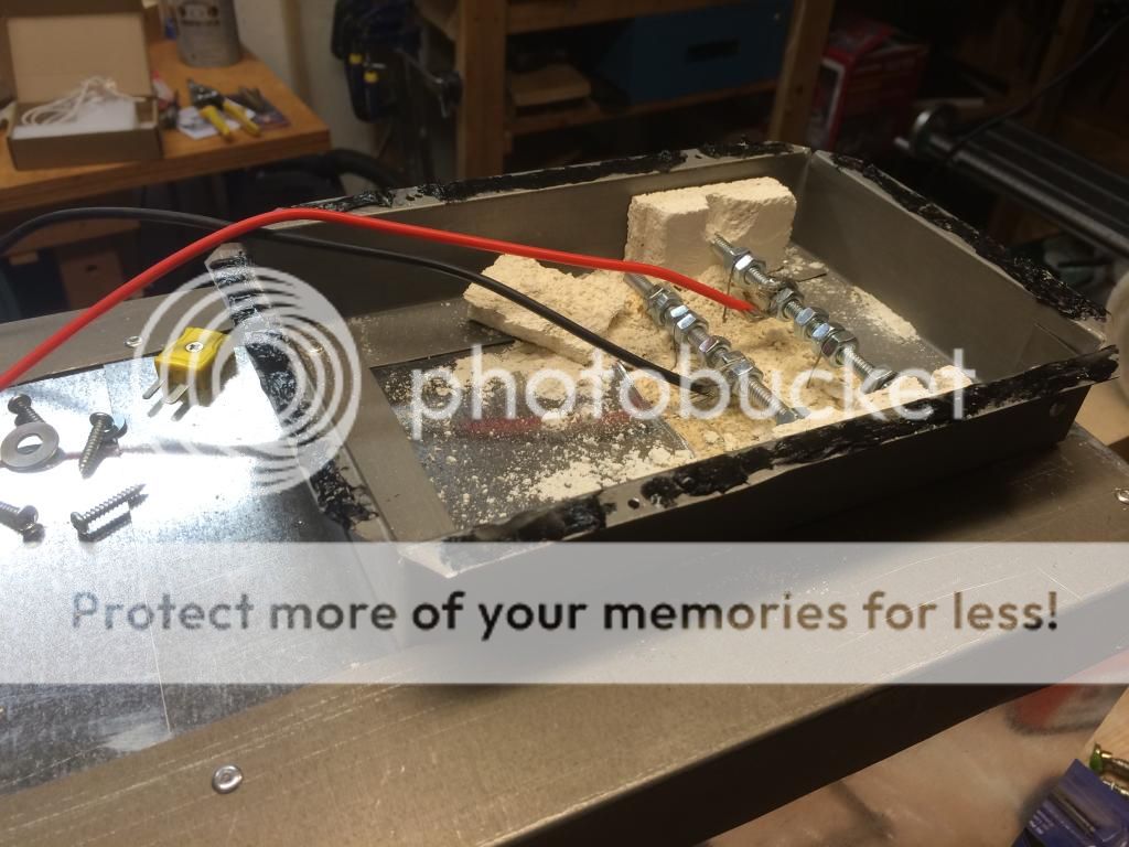

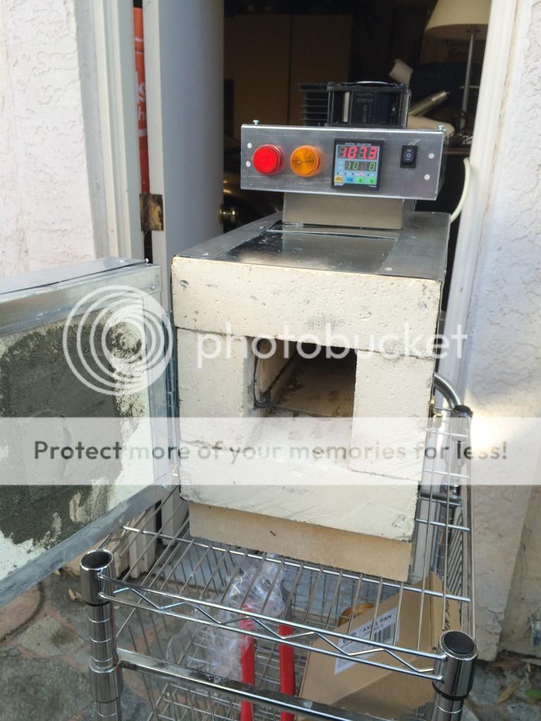

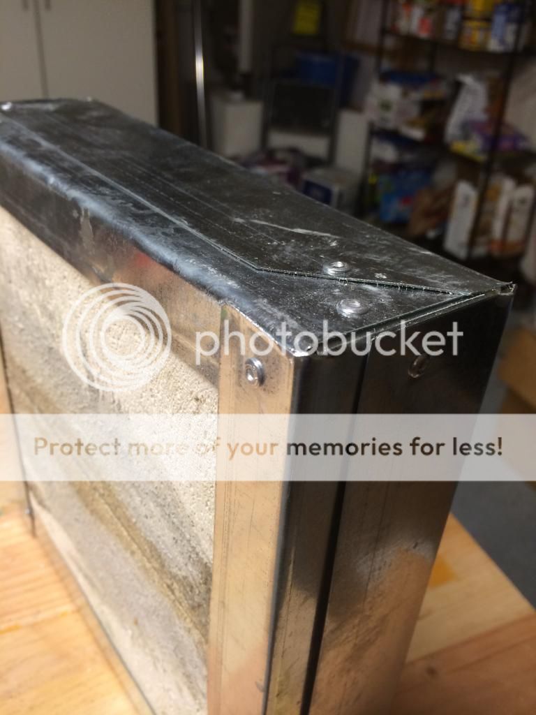

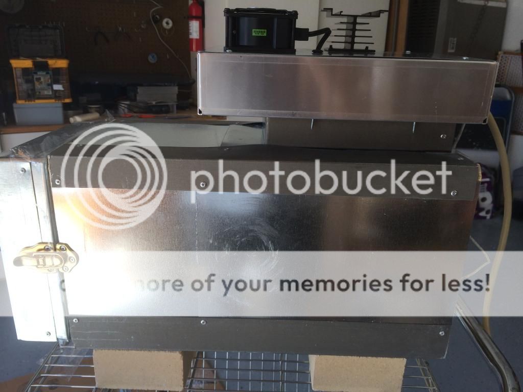

This follows fairly closely D. Corneau's heat treat oven. The main difference is I used pop rivets to form a sheet metal case instead of welding. This was really easy and I am very happy with the results. It was fairly inexpensive too -- pop rivets are cheap and I used roofing flashing from Home Depot.

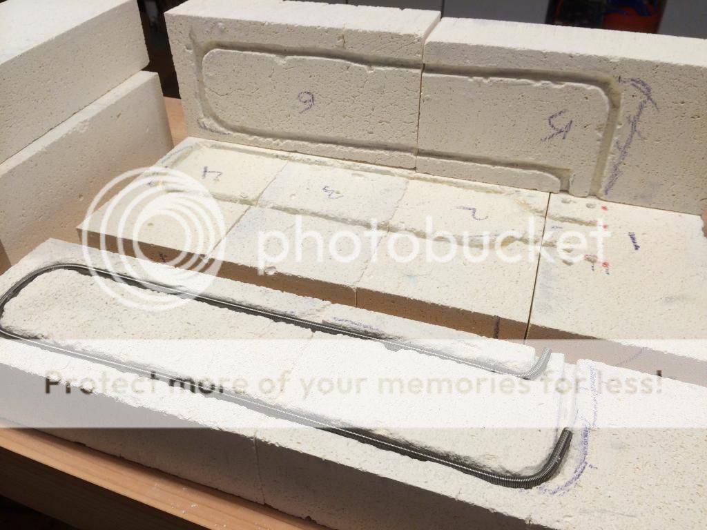

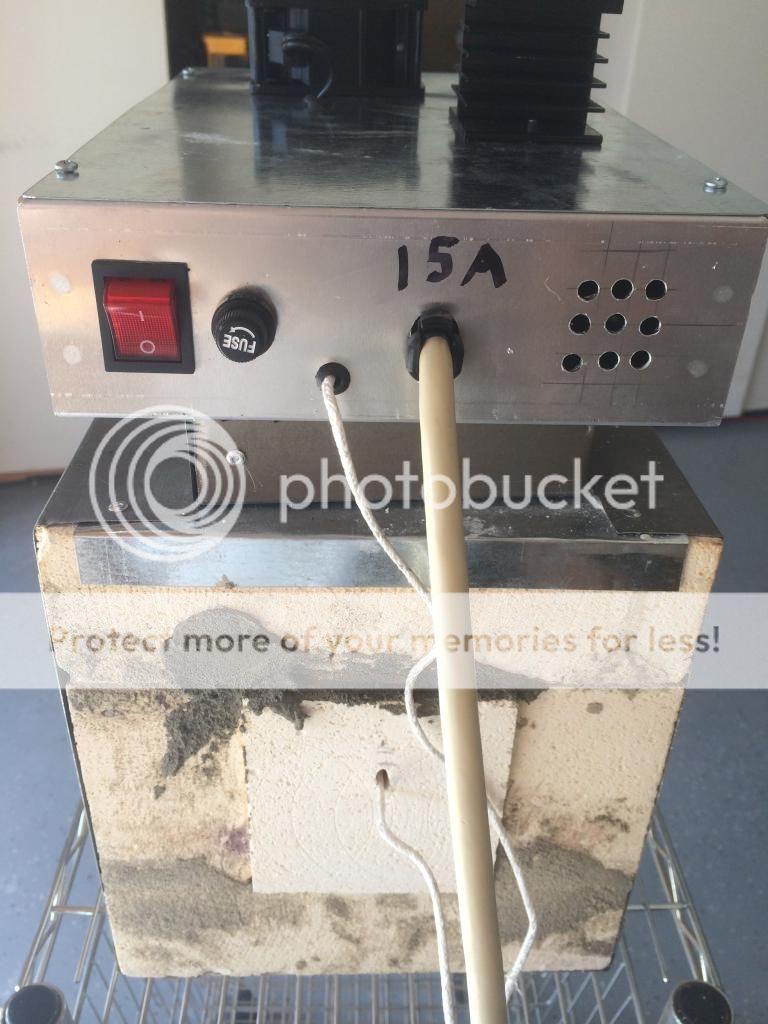

The electronics are a MyPin TA4 PID controller with a K-type thermocouple and 3x Kanthal A1 coils (in parallel). The current draw is around 12 A @ 120 VAC.
I haven't gotten this up to heat treat temperatures yet but initial testing seemed to go well. I did find that the heating coils like to move around when they heat up and had to add a few more staples to hold them in place.
