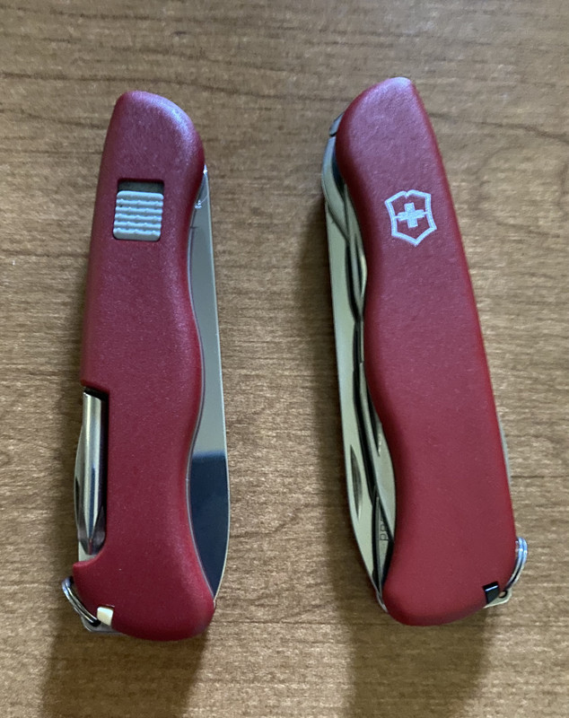

I only have one 111mm model with both locks…the Adventurer. The slide lock version has the same amount of vertical play as the liner lock. But, all of mine have it, I just thought it’d be interesting to compare the two versions.
One thing I will mention that caught my attention, the new liner lock version has a very noticeable half stop, the first 111mm Vic I’ve owned with this feature.
