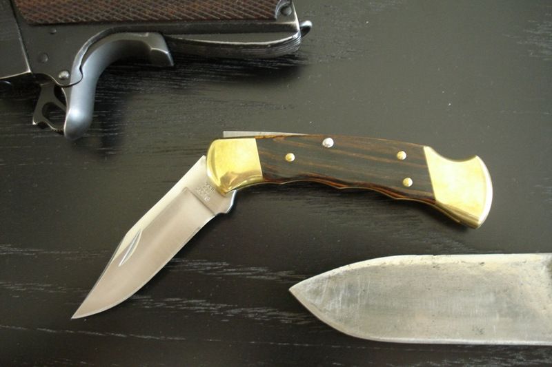

Hi everybody. I bought a Buck 112 online and, as aways, I asked the vendor to check for blade play before sending it to me. He followed my instructions to the letter, and I received a knife that locks up like a vault. The problem is, the knife opens very smoothly until about 60 degrees, then it gets gritty and stiff until it is completely open. So far, I have done this:
1. Washed it thoroughly with hot water and scrubbed the pivot area with a toothbrush.
2. Dropped a few drops of oil in the pivot and worked it, repeatedly opening and closing the knife. I did this a lot, and removed most of the remaining gunk.
3. Left the knife half open at various positions during the nights, to see if the backspring would give up a little bit.
I must say the grittiness has all but gone away, but it is still abnormally stiff to open. It seems the bolsters are just too tight. It is perfect in every other way, I won´t send the knife back to Buck, but I must solve this problem myself. Is there anything else I should try? Any advice?

I don't offer a solution to your problem however what is the fixed blade in your picture?

155440, it is a 1070 knife a firend gave to me. He made it.

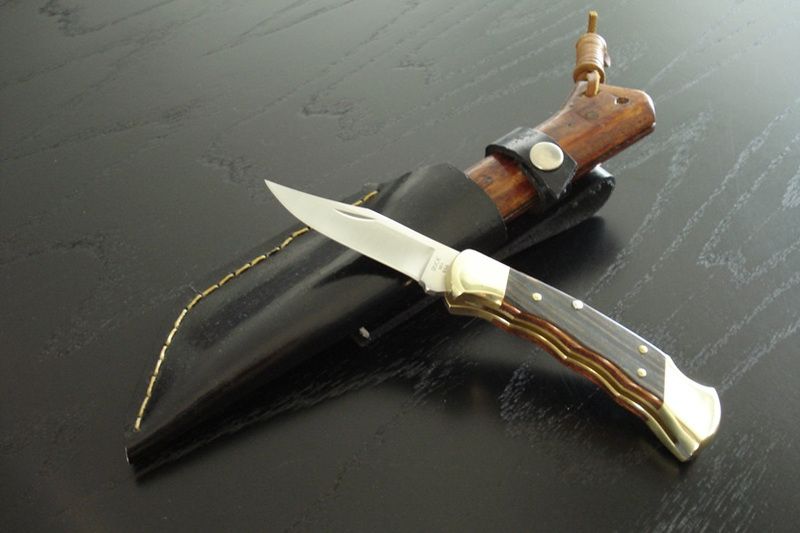

DocT, I regret to say the white toothbrush did nothing to improve the situation. I smeared a fair amount of it in the pivot area and worked it opening and closing the knife for an hour. The stiffness did not improve at all. I will take another picture and post it, perhaps I could try something else. I won´t be sending this knife back to Buck, I am sure you understand.
Chiral.grolim, I have just done your test. When the blade is getting opened downwards of 60 degrees, it gets stiff to open or close, even with the lock-bar firmly and fully pressed. I agree that tight bolsters should pinch the blade regardless of the angle it's open, but that is not what is happening with this knife. It starts opening lightly and smoothly, and suddenly it gets stiff. I will take anoher picture to illustrate what I mean.
Pack Rat, the picture in the first post is an actual picture of the knife. It is very unlike a new Buck 110 I had (post 13 in this thread). This new 112 is impossible to open one handed. I want to be able to open it one-handed, yes.

Another picture.
The knife opens easily and smoothly until that point. From there onwards it gets stiff to the point of it being a hassle to open with dirty hands. Lockup is very tight and solid. When the knife is open, the lockbar touches the tang fully and smoothly. No bladeplay whatsoever in any direction.
