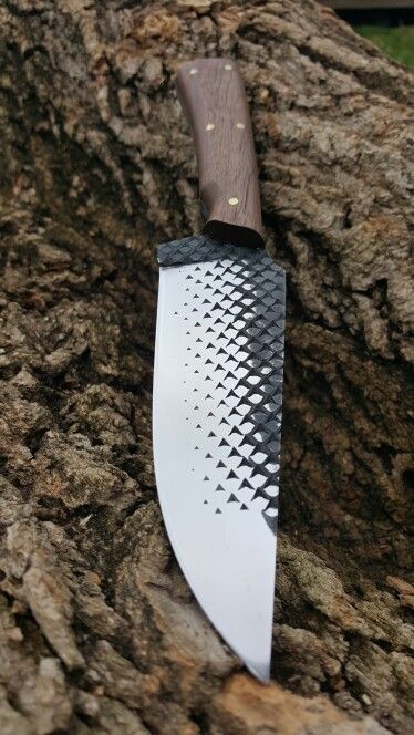

This bowie was made with a black walnut handle and a rasp guard. I used stock removal so I could leave the file teeth on the spine.

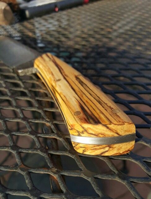

Here are some knives also made to practice bevels. The woods used are unspalted and spalted canadian birch with copper pins. I'm not sure how I feel about the copper, I think next time I use these woods I'll use brass.

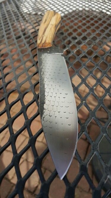

Wenge wood was used on this knife. I really like how this one turned out, it looks more appropriate with the copper pins I think.

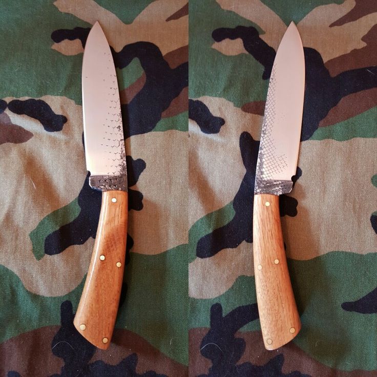

I tried to forge this blade as close as I could to the final shape, The bevels were cleaned up with hand files and sand paper only. Took it to the grinder for a bit just to refine the profile. The handle is white oak with brass pins. This blade was edge quenched and you can see part of the hardening line in the scale on the spine.

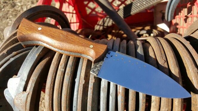

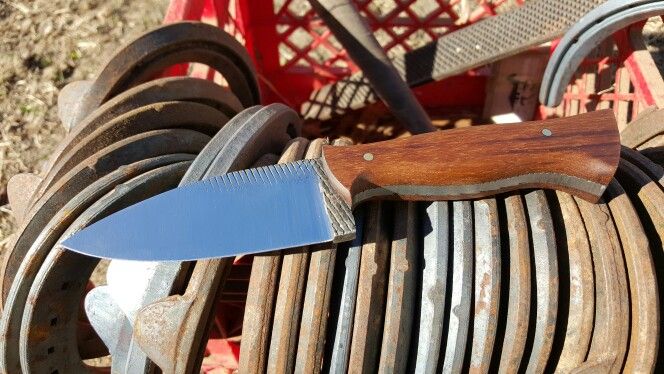

Hey guys, haven't been able to complete a knife in a while. Rugby season started and that's where a lot of my free time has gone. I made this one the other day, i like the design and find it really versatile. The blade is 5 inches and the handle is black walnut and brass which is quite comfy.
Let me know what you think! Im always looking to improve my knife designs.
